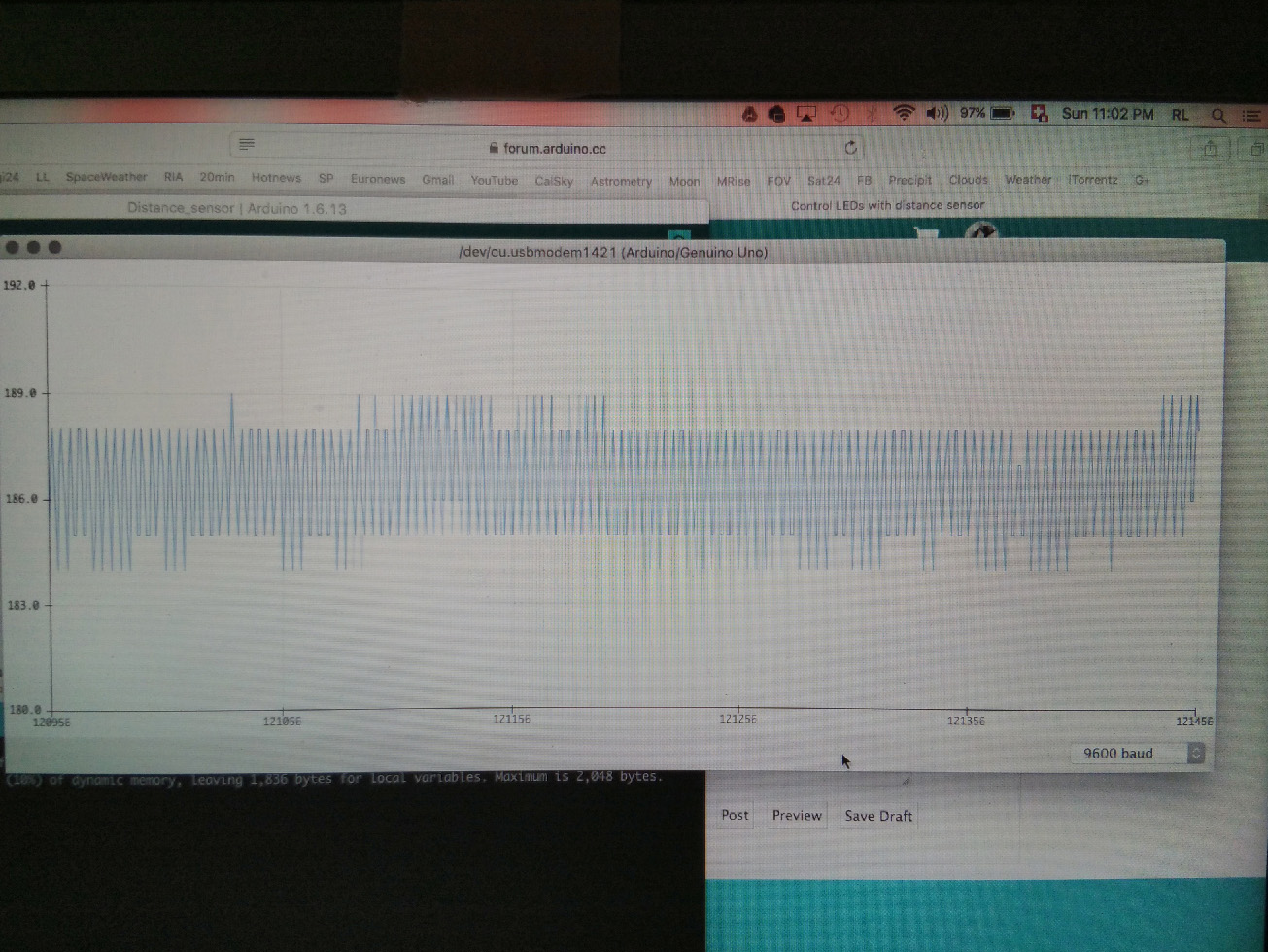

Your sketch prints the averaged value it is reading to the Serial monitor. What values do you see there when there is/isn't an object in front of the sensor?
The average value when not detecting is about 42. The average value when triggered varies, and is between 150 and 250, depending on the object and distance to sensor.
I have attached images of the serial plotter for each case.
Thank you for your help, much appreciated.
That value of 42 will be read as LOW by digitalRead(), but 250 is not high enough to read as HIGH. It should be 900+. Do you still have a resistor in series with the output?
