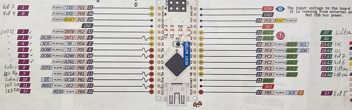

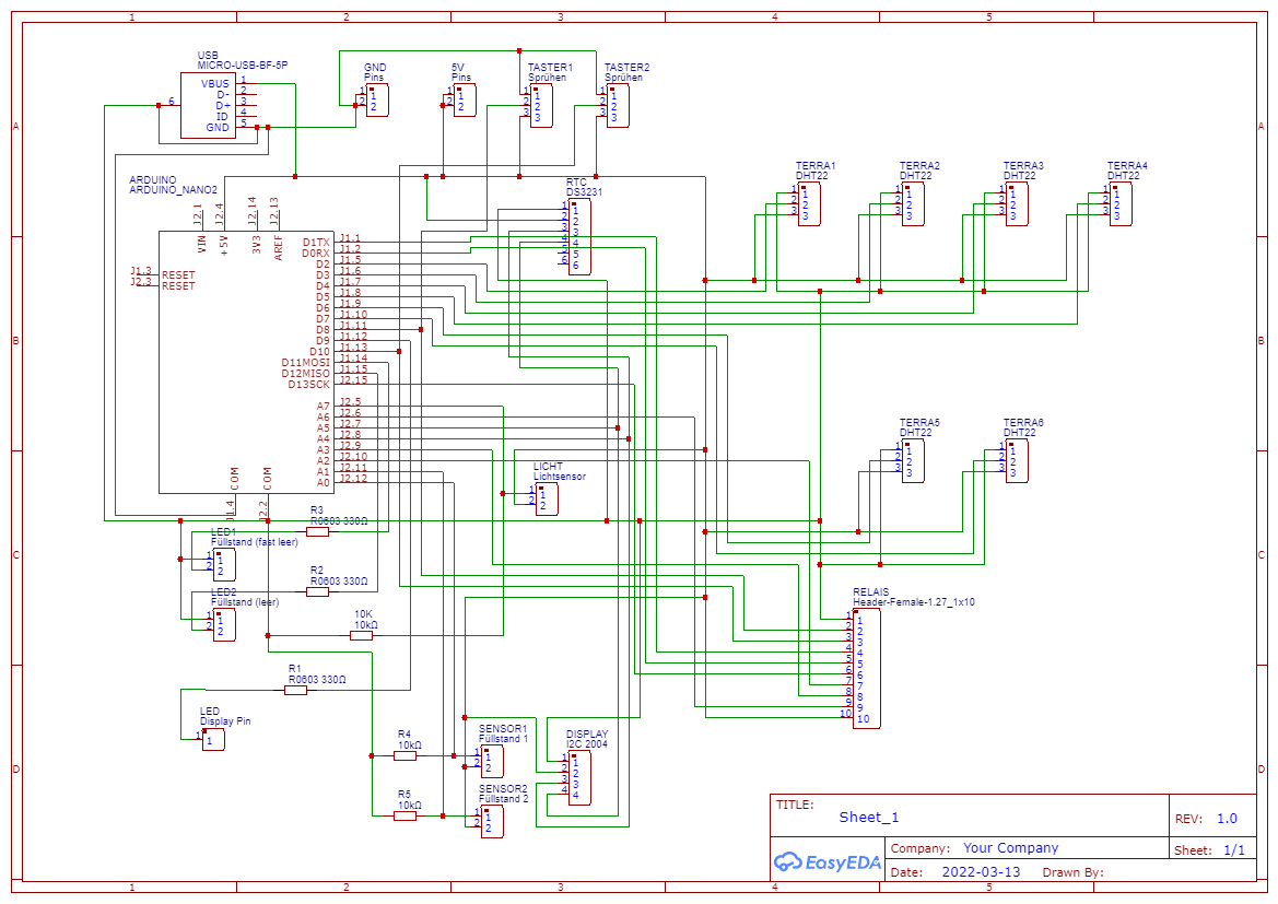

Hey all,
I am trying to control my 3 terraria with an Arduino Nano and the use of 6 DHT22 (2 for each terrarium) , 7 relais (for heating, light and the waterpumps), a DS3231 RTC, some LEDs and switches for the water level.
Where is the problem? My code does not do what I want it to do :smiley: . My Arduino is a little short on inputs/outputs. So I have to use Pin 0/1 for some funktions.
I implemented the necessary libraries and made a (you might laugh at me) noob-like code to run. I already used a similar code for my other two terraria and it runs for years now. It is way simpler though, only for controlling the humidity with DHT22, a DS3231 and a Display to show it all.
I cannot, for the love of God, figure out what I made wrong with my code (other than looking funny to all of you I guess). Is it because of the pins 0/1 I used? They should be ok to use since I don't use a Serial connection.
What I did so far:
I reduced the code to it's minimum(from top to bottom). And it works as far as showing all the temperatures and humidities on the display, also the time and light-level of the lightsensor. The LEDs for my water-tank work fine (of course the two switches work fine, too).
I added more and more code but when I get to the part with the if-statements it gets funny. I tried simplifying the if-statements as to only look for the time and then switch the relais on. It does it but only for a fraction of a second. Same with the light.
I tried using a different DS3231 library but I had no luck with it either. (although updating my current library made my code run less 'funny')
At first I tried switching all the relais on the way they are wired and it worked.
As a last resort I tried replacing all the temperature floats with integers. Didn't work either.
I checked all the wiring, looked for shorts. The wiring is good. My guess is that it has something to do with my code and/or the libraries.

Also a picture of my 'wiring', well, at least how I planned it.
I hope you can help me.
Sorry for my bad english...

Can you please post a schematic of your project?
Include component names and pin labels as well as power supplies.

For the schematics:
I made a custom PCB for this project. For easier access (well, I don't like the mini USB) I added a micro USB port to get power from. It (and everything related) is powered from a 5v 2A charger.
Pin A6 is just a dummy and not used atm. I just thought I'll add it to the PCB when I might need it.
