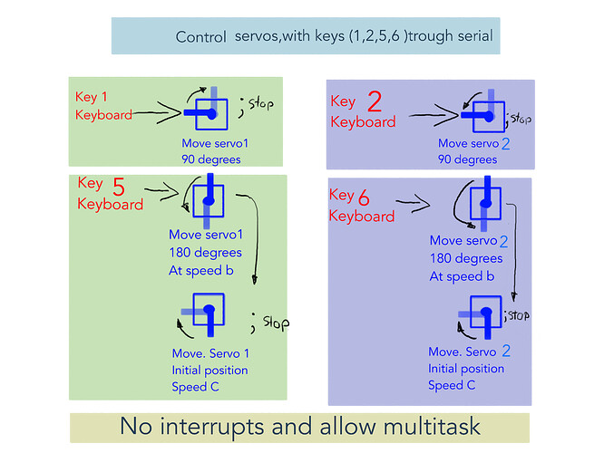

control of multiple servos with input though serial multitasking.
I'm trying to do a basic project servos controlled by keyboard at different timing and speed.
the idea is control different behavior of servos trough the key board.
my only correct approximation is these sketch that runs with delays. (attached at the end)
the big problem here is: If I send a new input before one of the tasks is finish. The new task don't would start until the end of the previous task.
I know that use delays is not the correct way to do this, maybe use millis and put the things in a class.
but when I follow some tutorials neither of them work for me. When I try to initialize the action with the signal from the serial in this case the keyboard. everything is a mess.
I already tried to modify my sketch based on this examples but without success:
Thanks for any advice this is my forth day in the research

Thanks for the help, but I continue without success,
I'm attaching a sketch of what I am expecting for when I press the keys on the serial port. my sketch do the basic. But with the problem of the (blocking) with the (delay) function.
I tried to use VarSpeedServo.h but this library use interrupts, and looks that this is not compatible with Blynk.
I dont know if the problem is the "delay" in all that parts of the code. Somebody know a way to change this "Delay" for another thing but keeping my condiition : if (val==1) that represents the keyboard "1"?

The reason is that I'll need merge this sequence later into a blynk project based in a board esp8266 that don't admit interrupts for the correct functionality.
but more that the blynk reason is that right now each sequence is blocking any answer of a new input. For example if I press 5 the servo will run, but I'll need wait until the first sequence ends to see the response of another command sent previously by the keyboard.
So if I press 5 and 6. 5 is executed immediately (servo 1 moves), but the inside of the command 6 will be execute until 5 (servo1) ends.
I'm expecting a behavior that each motor could respond independent with out wait another motor to ends.

ivanoff2019:
Then you weren't using VarSpeedServo correctly. I bet you added the 'wait' parameter which turns each write into a blocking version.
Your latest code is full of for loops which are also blocking constructs. Nothing else runs until the full 0-180 move is complete. If you want non-blocking speed control you need to use millis() for the actual servo move. You can't use for loops.
Steve
Learn about state-machines perhaps?
