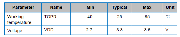

The voltage supply, to the ATMega328P and LoRa device looks like its a Lithium battery, since its labelled as 3.7v, If its a lithium battery, that could be 4.2v. What is the maximum voltage for the LoRa module you are using, you will find that information in the devices datasheet ?
What does the ATmega328P datasheet say is the minimum working voltage for a 16Mhz crystal ?

  • LoRa module max 3.6V:
Which will actually be 4.2V fully charged ..................
Thanks, this has been forgotten...
ai ai, I must add one more voltage regulator.

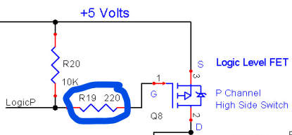

usually there is a small value resistor between the MCU pin and the gate... at the blue dot:
Figure above courtesy of @LarryD
