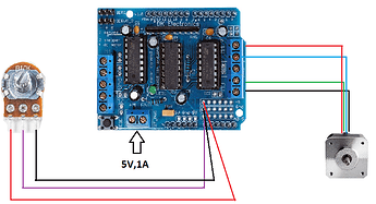

Hello. I am new on arduino. I thought it is so easy, but it isn't. I am useing Arduino UNO and Adafruit Motor Shield V1. I have a problem by control stepper motor by potentiometr. I want the motor to increase speed as the value on the potentiometer increases. At the moment the motor turns at one speed only when moving the potentiometer. I check many code's and I programed on visuino but neither works just I want.

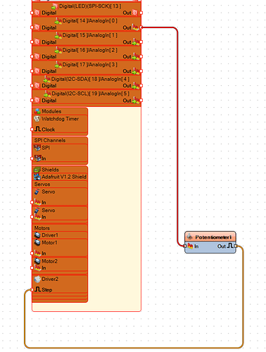

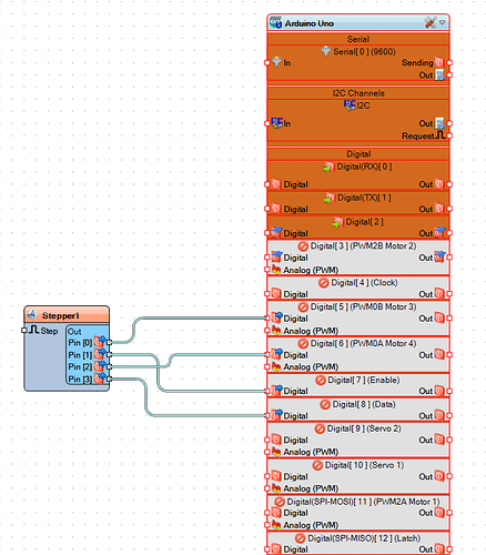

Mayby who know how to connect stepper motor and potentiometr in visuino to adafruit motor shield because this connection in the attachment does not work.

The picture You posted is not readable no matter what I try to magnify it.
In a project like this make test code verifying that reading the pot works and You understand it.
The second part would be running the stepper.
I would like You to post a link to the stepper shield datasheet. I didn't find it directly.
Please, also provide schematics showing pin names and power supplies.

Please post a data sheet or a link to where you got your stepper motor. That ancient motor shield is not an appropriate driver for a modern bipolar stepper motor.
