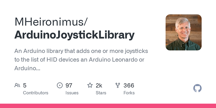

Arduino Leonardo CAN act as a generic game controller. I believe there is a library but I've not used it myself (maybe once twice a while ago):
This should work on a PC but not necessarily on a console. I think a console is probably more restrictive on what USB controllers it accepts. I would encourage you to try this library sample code:
  1. first on a PC because it's supposed to work.
  2. Then try this on an xbox because I think xbox shares some code base with windows 10 (why making two same but different things, right?). If that works, great!
  3. You can try PS but that's a whole different system I guess.
