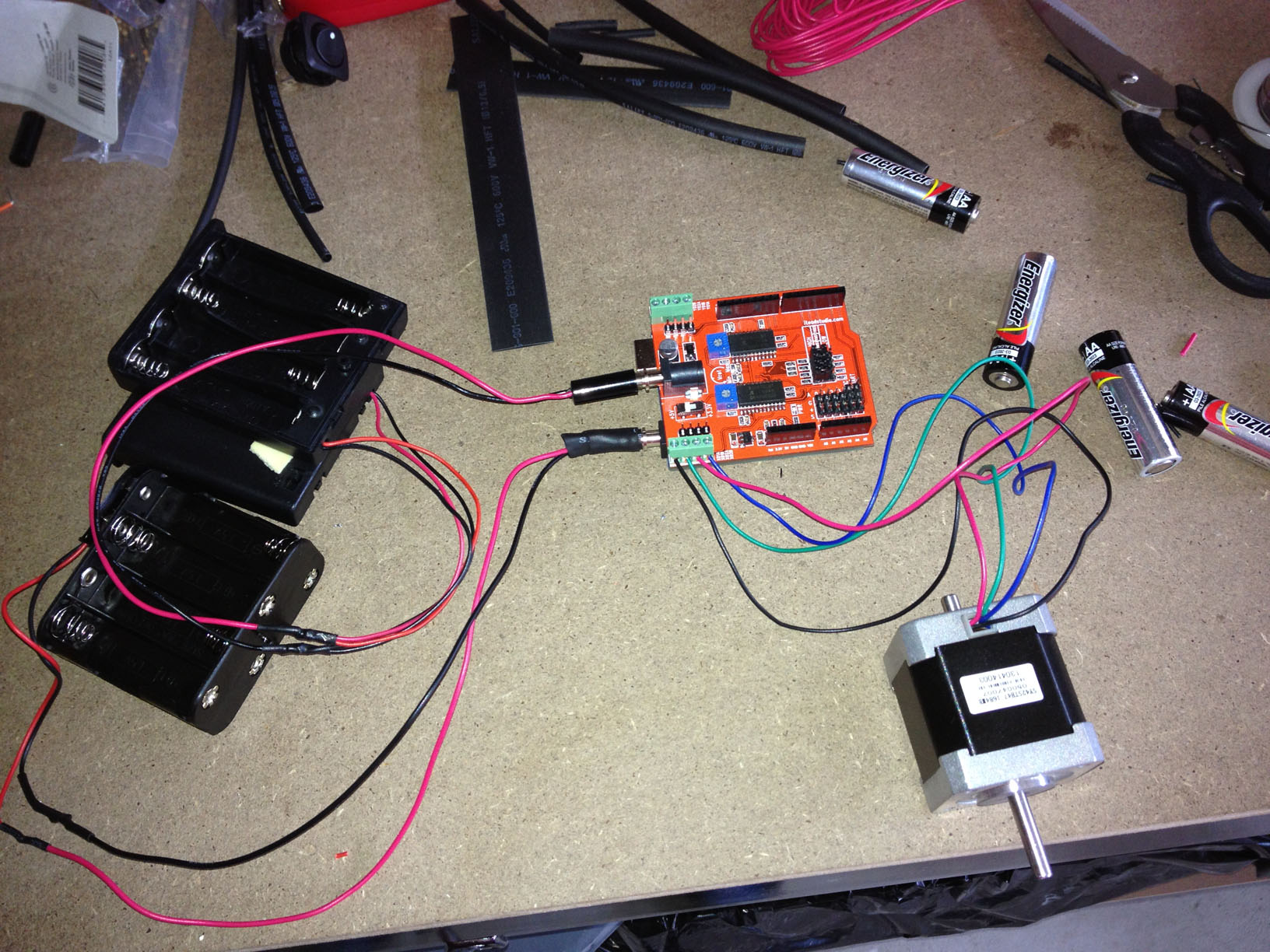

Controller Becoming Extremely Hot
Please help guys, not sure what I am doing wrong, I have two banks of 8 AA batteries one powering the Arduino and another one powering the Dual Step Motor Shield 1.1, I have finally managed to get the motor spinning however the controller circuit board gets extremely hot to touch, not matter what I do this happens. I have tried just running the motor with one bank of batteries (btw my controller is piggibacked on the Arduino) through the arduino one thing that that it takes the motor a second or more to start spining however the circuit still gets very hot am I missing something obvious.
You should read the sticky note at the top of this forum. There are no links to the hardware you used and you didn't provide the code you used for this. It might have been a good idea to post a drawing (or photo) of all the wiring you've done.
How should we help you without the necessary information? That's why there's a sticky note everyone should read before posting.
These are the pictures of the setup, code and hardware I use.
Hardware used
Controller
http://robotics.org.za/index.php?route=product/product&product_id=170
Arduino Uno
![](http://forum.arduino.cc/Users/markoarsenic/Desktop/Arduino Setup 1.jpg)
![](http://forum.arduino.cc/Users/markoarsenic/Desktop/Arduino Setup 2.jpg)

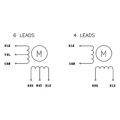

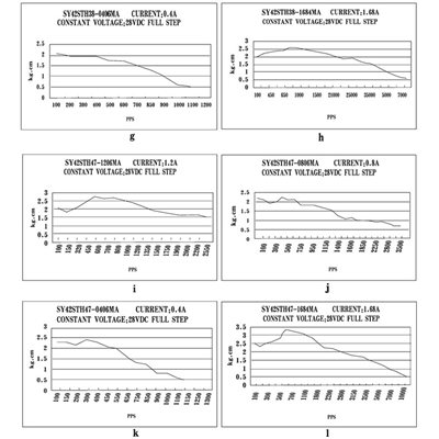

Do you have a link to the datasheet of the motor you're using?
I have requested the data sheet for the motor and will send it as soon as I get it, also not sure what you meant by to insert a code tag.
Your stepper motor has four wires so it's a bipolar stepper motor. Your shield is designed for bipolar stepper motors. The CustomStepper library and your code is written for unipolar motors -- this is bad.
You need a different library, for example the AccelStepper library. Using that library the constructor for two motors (I'm assuming you'll add a second one later) would look like:
AccelStepper stepper1(AccelStepper::FULL2WIRE, 2, 3);
AccelStepper stepper2(AccelStepper::FULL2WIRE, 6, 7);
If you can put your finger on the chip (or the motor) and hold it there for a couple seconds it's not "too hot", but a heatsink would still be a good idea.
I can't tell you how much you have helped me thank you. The issue with heat was that it got so hot to the point that you couldn't keep your finger on the chip for a second, will try with this new program do you think that there is an issue with how much power I am supplying to the boards and also if I wanted to install a small fan how would I connect it as this setup would be running for hours and hours and I don't want to cause damage.
With your previous program you were toggling the MS1 and MS2 pins (which set the microstepping) along with your STEP and DIR pins. Apparently that rapid toggling of those pins causes the chip to overheat. Otherwise, the heat should be controllable by adjusting the trimmer to a lower current setting.
The chip has overheat protection and should shut off at 165oC, btw. Not that you want to push it.
