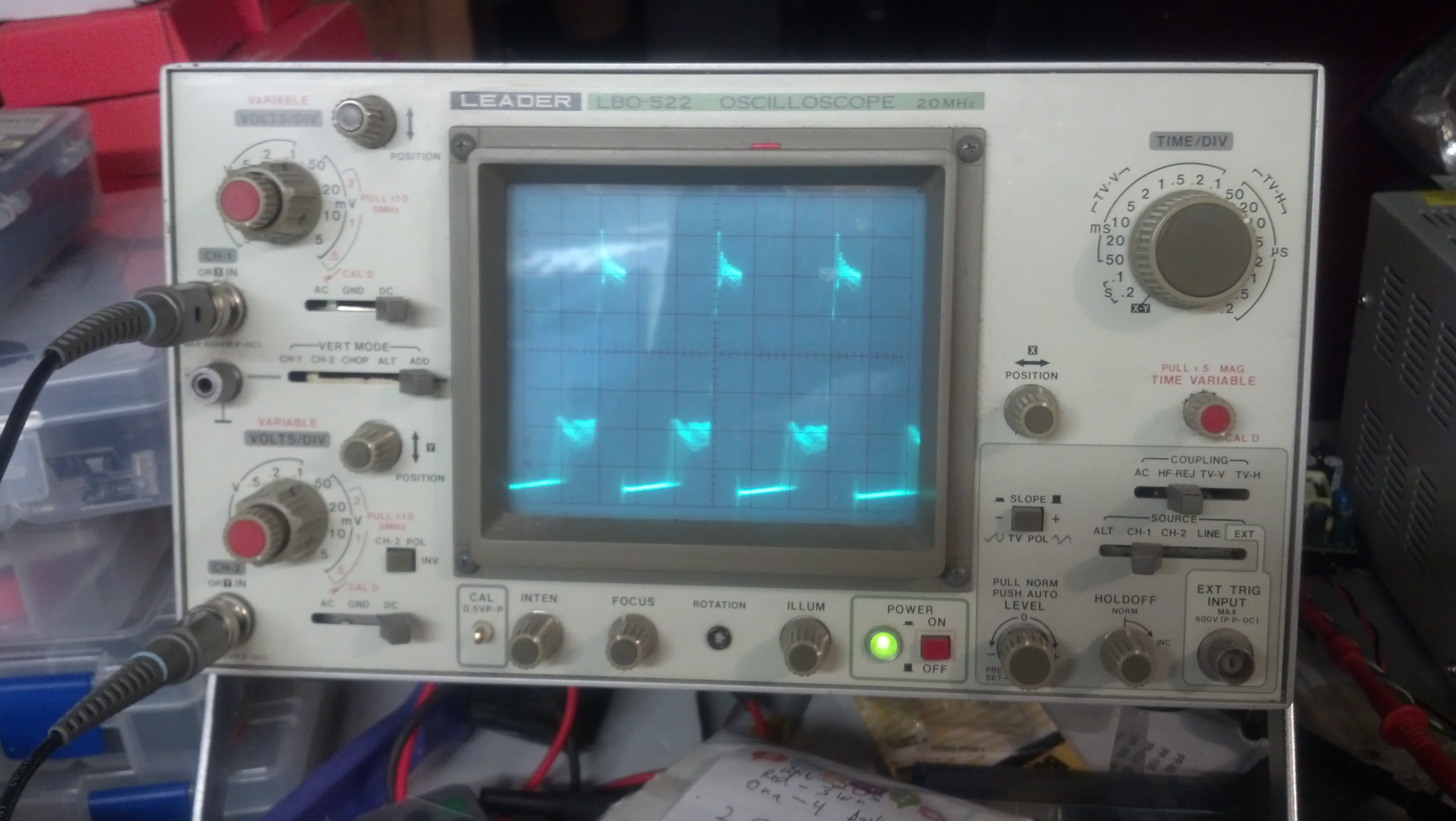

Getting back to the PWM waveform. The below is a 16 kHz pwm signal across a 12V motor driven by the same mosfet linked above. As you can see, it in NO WAY looks analog. There is absolutely nothing remotely analogISH about the waveform. It is CLEARLY a PWM with the slight changes I mentioned.

Again I ask you, does the waveform in the photo below look like ANALOG to you ?
