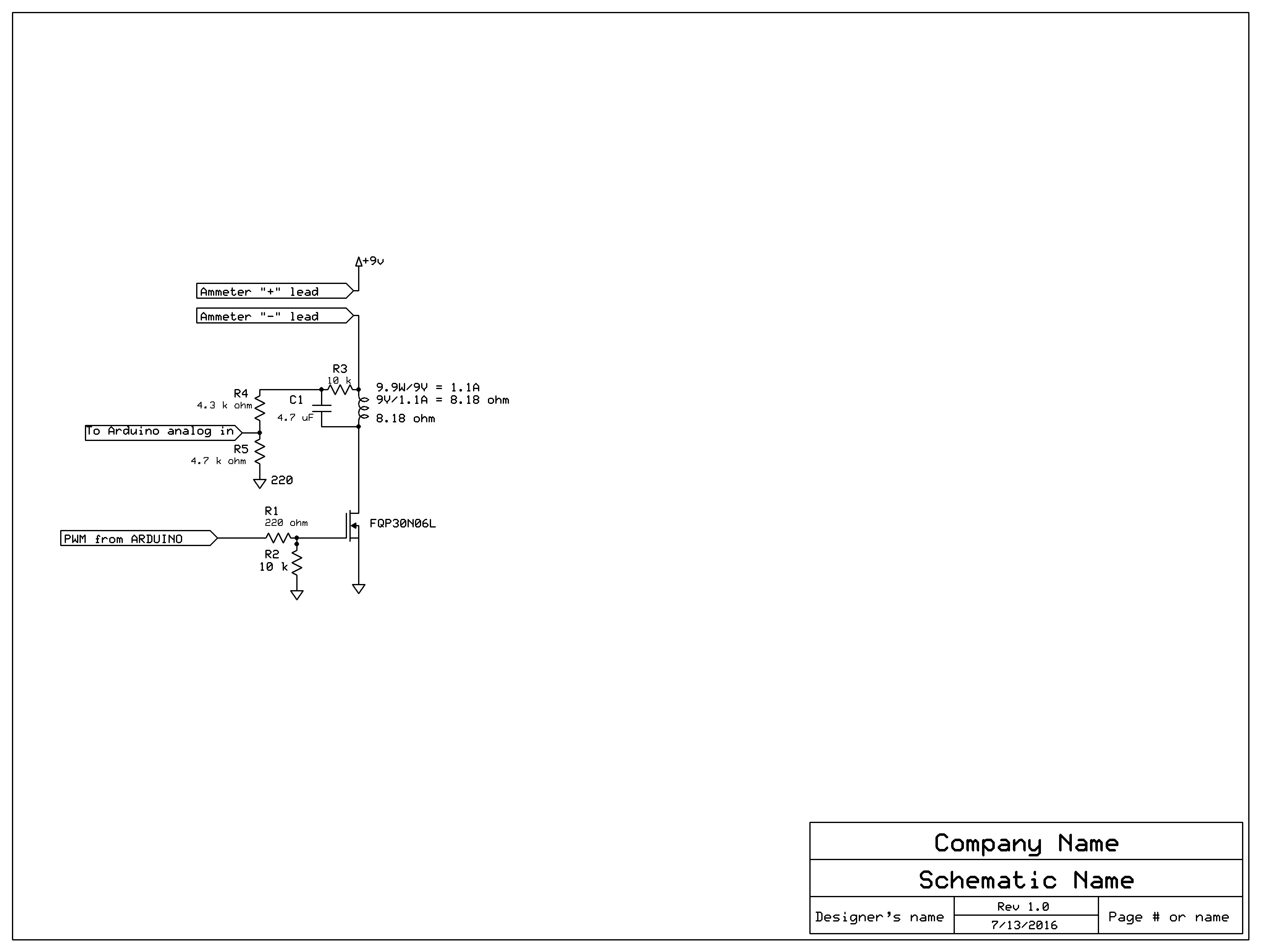

Hi All,
I have recently brought a heating pad from amazon (link) and now I'm looking at getting a MOSFET to control the voltage from 5 to 12V.
I had a look for MOSFET that I could possible use. I see this on amazon and was wondering would this be okay to control the Heating Pad, as I don't have much knowledge of MOSFET, so I'm not fully sure about this.
Many thanks
The key for using a mosfet with an Arduino is the use the type known as Logic Level Mosfets, typically denoted by the L in there product code such as the one you show irL88.
That device will handle up to 30 V at 60Amps so should be ok for your heating pad.
You need to complete the circuit like the pic shows, where typically Rin= 220R and Rgs = 10K

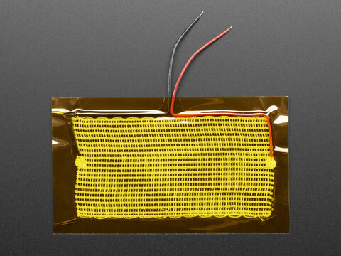

That pad is about 9.9 watts, a 9V transistor battery will last about 1 minute :o

outsider:
Electric Heating Pad - 10cm x 5cm : ID 1481 : $5.95 : Adafruit Industries, Unique & fun DIY electronics and kits
This is similar to heating pad that was available on amazon. Still waiting for an answer for the resistance of the pad. So far nothing.
Also, the link you provided for the heating pad has a link to the MOSFET that is required. If I don't hear anything from amazon I buy this one and see how it goes.

NO.
Your circuit schematic has numerous errors. see attached.
(the 10 k resistor and cap were in the wrong place)
For clarification, previous reply was addressed to Runaway Pancake.
Given that someone else posted the power rating of your pad (which you failed to include) as 9.9W, I have taken this rating to be correct and calculated accordingly . If you have information to contrary please advise.
Given P = 9.9W,
I must be P/V = 9.9W/9V = 1.1 A
Given I = 1.1 A,
R must be V/I = 8.18 ohms
Your 9V power supply must be rated for at least 1.5A
You have provided NO information.
You have NOT provided ANY ratings or specs for heating pad.
You have NOT provided ANY part number for MOSFET.
Without the part number of the one you said is recommended, I have temporarily supplied a part number
You have NOT provided ANY details about your 9V power supply (current rating etc)
The ameter goes in series between the 9V power source and the load (the heating pad)
The heating pad goes between the ammeter and the mosfet drain.
I have shown where to connect ammeter "+" and "-" leads.
Current and resistance are calculated from the 9.9W rating posted by someone else since you provided no information.
Voltage divider values should yield 4.7V at 100% duty cycle (pwm value = 255)

The values shown in the diagram for R4 = 4.3K and R5 = 4.7k, could you please explain how to calculated them.
