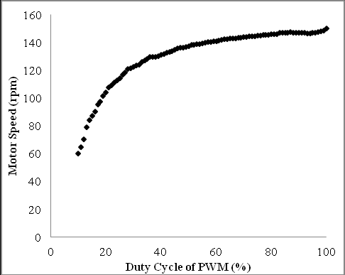

Speed will depend on motor load, heavier load, lower speed.
No, motor speed versus PWM typically looks something like this (for no load on the motor shaft). Below some percentage value of PWM, it won't even start moving.
