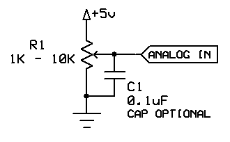

How to wire a pot. The 5V and ground can be found in several places on the Ramps board. Pins 1 and 2 of the AUX-2 header are 5V and ground respectively. The cap is optional. It will help to bypass noise to ground and stabilize the pot reading. The value is not critical. Can be from 0.01uF to 10uF or more. I use 0.1uF usually.
I tested the thermistor inputs with a 1K and a 10K pot and they seem to work just fine. They read out the full range (0-1023) and look linear in the serial plotter. On the thermistor header pin 2 is A13, pin 4 is A14 and pin 6 is A15.
