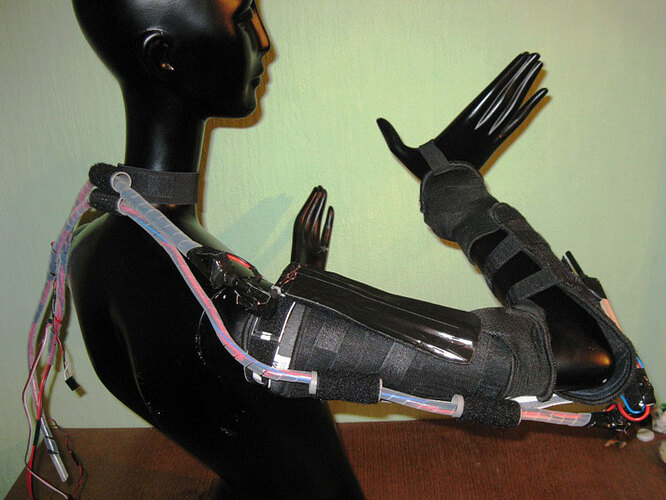

It supposedly makes a resistive bend sensor; probably isn't as consistent as a purchased sensor, but likely a lot cheaper. You might be able to acheive consistency though by using screen printing or similar methods to lay out the "glue traces"...
Now - since those pics look similar (same?) as the instructables - was the instructables posted by images, or is it going the other way around?
I still think the conductive glue method might be the more interesting of the possibilities - if you could screen print a pattern of lines on the back of a glove (across the knuckles, for instance), then attach wires appropriately - you could make cheap "wired gloves" for more experiments of this type...
I believe Images posted the Instructable. The guy behind Images has written several DIY type books as well, I believe.
The flex sensor is quite cool, but even though I did not particularly like it on my first run, I believe that the stretch sensor is an extremely versatile and easy to use tool. I will be buying myself a couple of feet of that material. (and as soon as ive cleaned up my room, Ill post some more info on it on my blog... just procrastinating here :-/)
The idea of screen printing circuits is quite awesome. I wonder if it would be washable? (oh man... this is cool actually...)
However I simply don't have the time to experiment with that at the moment, as I also need to get the software side implemented and that will be a pain, I'm afraid... --> I have another thread running on the software implementation (which sadly sort of got out of hand right away :-(...) http://www.arduino.cc/cgi-bin/yabb2/YaBB.pl?num=1286040869
I should probably open a new thread, as the title really is not too represantative of where this project has gone...
anyway, check out my newest video:
I have finally actually thought about the code aspect and not just butchered something together, also the way the sensors are mounted on my body has greatly improved in terms of usability...
