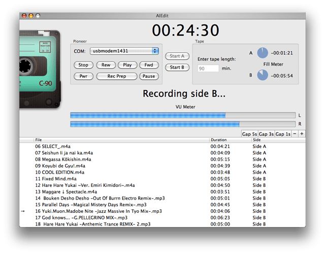

This is how the controlling app looks like:
However most of the work is done on the Arduino itself. This is the code:

The whole thing is also integrated with AIEdit, the tape recorder app:
For more info, see the github project: GitHub - vladkorotnev/TapeStuff: Integrating cassettes for the sake of music
However, it still has a problem — I have to send all the commands twice (for example, to make it play, I need to send "PP" to arduino instead of just "P", and such). Not sure what did I do wrong so if anyone has a suggestion, that would be much appreciated!
Thanks for reading! ?????
