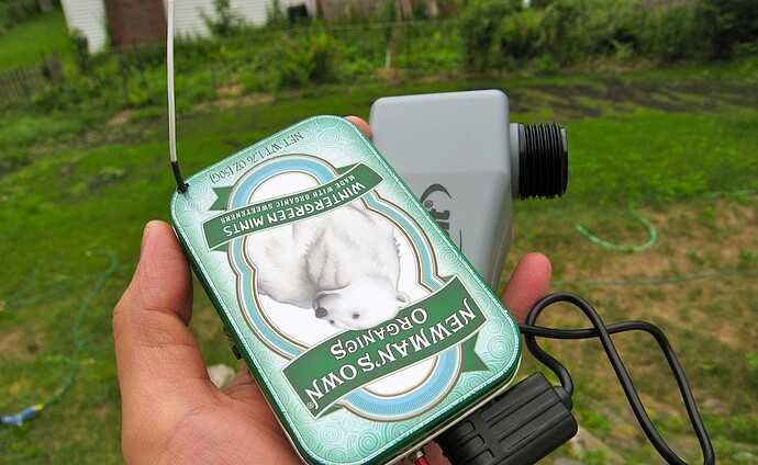

Hi guys,
I want to use my Arduino to control a water valve that hooks directly to my house.
I had this in mind
http://www.lowes.com/pd_904-74985-27757_0__?productId=3047175
What can I use to power it? Could I just external batteries and then a relay type thing to turn it on and off?
First project and I am not exactly sure yet.
Thanks for all the help!
Hello and Welcome. To start, you'll have to find out how the valve is powered. I see that it requires 2 AA batteries so it seems that that would be the supply power. You'll also have to find out what turns the valve on. Once that information is available you can move on. - Scotty

You forgot to ask Google? - someone's used this (or a similar model) before and done the work for you:
There are lots of solenoid valves that will do what you want, you will need to sort out power and a relay or transistor, you could use a relay board / shield for arduino and not have to solder a thing.
