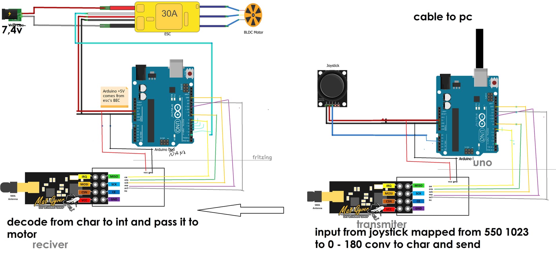

Hi, I have an issue to control my motor trough data received from nr24l01.
Data is being send without any issues. I controlled this motors via cable by joystick using this tutorial: https://www.youtube.com/watch?v=cUdDNul4ybQ&t=180s . I can`t figure it why motors does not spin while controlling via wireless transfer.
Code for transmitter:

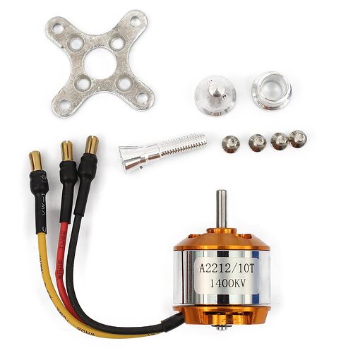

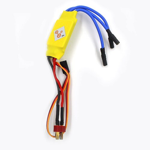

Post an annotated schematic and show exactly how you have wired it. Be sure to include all power sources. I missed the link to the motor, be sure to add links for each hardware device. Hint: I do not read frizzes or word schematics.
https://allegro.pl/oferta/adapter-nrf24l01-8pin-do-modulow-bezprzewodowych-jomardyan-16574-13280985633?bi_s=ads&bi_m=productlisting:desktop:query&bi_c=Y2U4NWU4MTgtNTY4YS00MmIxLTk5MGMtODQ5ZmJlZmIwNGYzAA&bi_t=ape&referrer=proxy&emission_unit_id=0327a5b3-b929-4a75-ac13-5f384489139d
https://allegro.pl/oferta/modul-radiowy-nrf24l01-pa-lna-2-4ghz-ze-wzmacniaczem-i-antena-12679799872
https://uelectronics.com/wp-content/uploads/2020/10/30A-BLDC-ESC-Product-Manual.pdf

In your transmit sketch you are mapping the servo range to 0 - 180. (Degrees)
In the receiving sketch you are using 1000 - 2000 (microseconds)
This is best very confusing, and at worst is the cause of your problem.
it's the way it worked without wireless communication. Or should i send by transmiter values from 550-1023 (joystick default values) and convert them in reciver?
The wired code you posted writes 180 to all speed controllers. I looked at the servo.h code a bit and found a reference to a method called something like “servo.writemillis”. I cannot recall the exact spelling. Anyway that method was capable of writing to the servo using the millisecond timing or if the value it was called with was in the valid range for an angle it would control the servo using the angle.
Anyway, I think we need to simplify a bit and take small steps. I notice that you have a serial print programmed in the receiver code. Have you seen anything print on the serial monitor?

One thing I haven’t asked about is if you are doing an arming routine for the ESC’s. Most often used routine is to cycle the command to the ESC to max throttle and back to minimum throttle.
