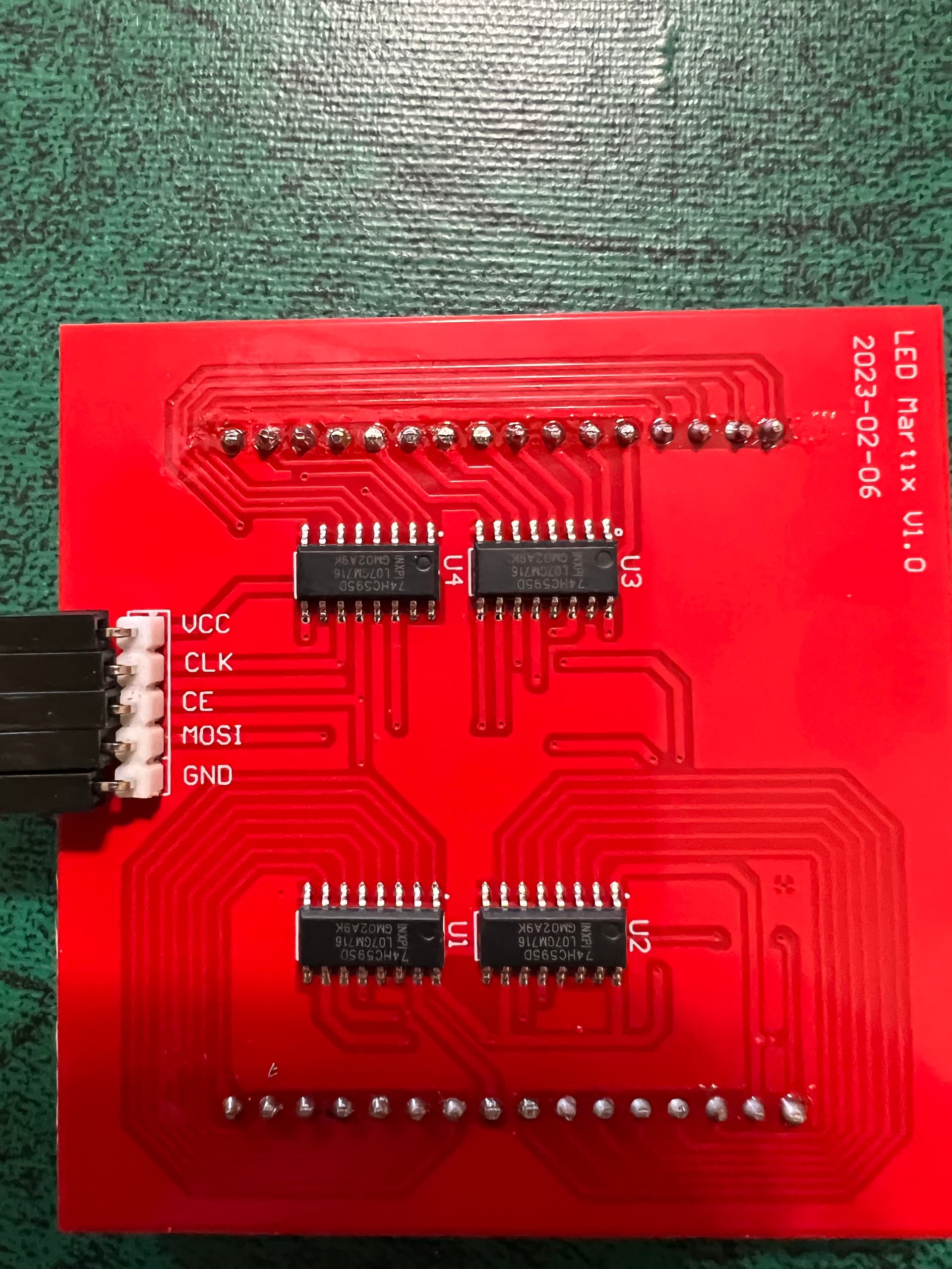

Can you find a schematic for the PCB behind the matrix?
I see 4x 74hc595 chips. I don't see any bypass capacitor or current limiting resistors. I think this is probably a poor design and would not expect it to have a long life. But it could be fun while it lasts!

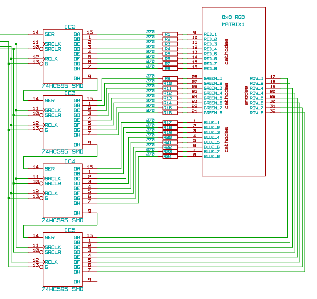

As far as I know, the 74HC595 does not communicate with a standard SPI protocol.
They have their own protocol.
In the 74HC595 datasheet, (page 4), you will find a time chart showing how the communication between a processor and a 74HC595 is done.
Apparently your board has the 74HC595 and the RGB LEDs connected as in the diagram below.
HTH
Looking at the PCB, the schematic seems to be a little bit more confused than that. See, one of the four drivers has it's wires all over the place while the other three seem to be connected in a more or less straightforward way.
@efeigenbaum, depending on what you want to do with it, seeing that there are no resistors in the PCB, it might be better to buy a different one indeed. This one wouldn't last very long.
But before I claim that with absolute confidence, could you check something? Are there components between the matrix and the PCB? Could you take a look?

Good point, there could be resistors, caps, and perhaps even some transistors on the other side of the PCB, below the matrix. I won't get my hopes up too much, though.
If there aren't any resistors, maybe that explains why @efeigenbaum has been unable to mix any colours. The lower forward voltage of the red LEDs, compared to the green & blue, will probably prevent the green & blue LEDs from lighting.
If I'm right, the only way to mix colours will be to alternate red, green and blue on separate scans of the matrix.
Indeed, so the way to mix colors would be to rapidly alternate between the colors. Filling up the capacity of the controller and being a very good second reason to buy another one.

As far as anything in between the matrix and the PCB - I see three small bumps on the matrix but can't tell what they are. See the picture.

@ruilviana I don't think we can be certain that schematic belongs to @efeigenbaum 's board. Seems like the guy asking questions in that forum was designing something similar, but from scratch. Later he was asking about adding transistors to increase the brightness, which would not be an option if he was using the same board @efeigenbaum has.
