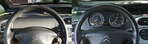

I want to put a BMW E90 instrument cluster into a car that only has digital display. So I bought one off ebay thinking it would be a fairly straightforward job. To my mistake, most of people who did this years ago have posted links that are dead now and they themselves are not available any longer.
I found the following resources
Several YT videos
I bought a Seeed Can Bus Shield V2.0 and connected it to my Arduino Uno:
and connected CAN-HI pin to supposed CAN-HI pin on the cluster and CAN-LO pin to CAN-LO of the cluster. I also connected 12V adapter to the cluster (+ to +, - to -)
the cluster does power on by wiggling the needles a bit and if I press the button on it, display turns on for about 15 seconds
but when I try to use the suggested turn-on CAN message, nothing happens. I tried both 500KBPS and 100KBPS, but still nothing. This is the code I used:

In the time elapsed I have made some progress. Initially I didnt connect the ground wire to arduino, thats why it didnt work. Here is correct pinout:
1     o o     10
2     o o     11
3     o o     12
4     o o     13
5     o o     14
6 C_H o o     15
7 C_L o o     16
8     o o     17
9 VCC o o GND 18
(Dont forget to connect GND to Arduino!)
I managed to turn the cluster on, turn on the backlights and move the rpm needle. But I still cant do it consistently and everything in the same program. I read that cluster is picky about how messages and which messages come and at what intervals. I try reordering the message sends a bit, putting in delays and sometimes I manage to move the rpm needle, sometimes the lights turn on, but cant make it consistently useful. There is information that wake signal should be sent every 100ms but I cannot make it work even if I send it every 100ms. It even happened that I put into program message for turning rpm needle, then I reupload without this message and the rpm needle moves. Maybe there is something about how Seeed CAN Shield sends messages (buffers etc).
I tested turning blinkers on by sending the command once in setup, but the cluster was acting as if it was spammed by that same command and showed CAN bus errors. Im starting to suspect there is something up with my CAN bus shield
If anybody could shed any light onto this I would be very grateful!
