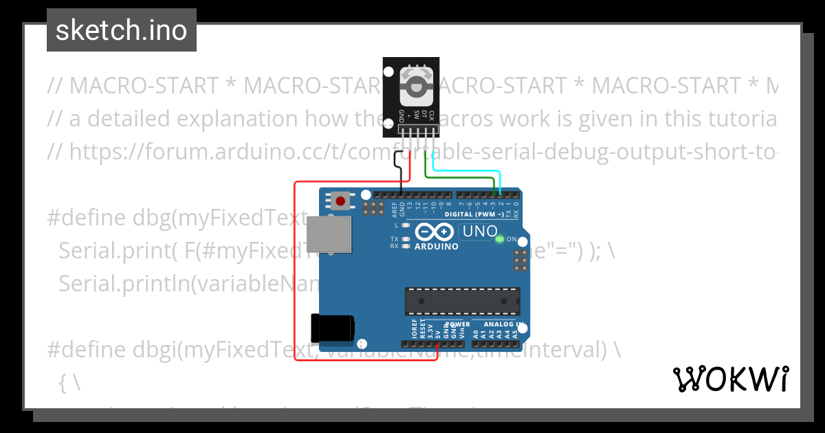

Yes I have tried controlling the motor like a servo using the below code. Also I looked for may such videos but in my case the type of motor didn't matched but yes I tried to understand the idea from it and atleast wrote the code on my own.
My code:-
int a=2;
int b=3;
int k;
int v;
int pp=9;
int d=10;
int pos=0
int angle;
pinMode(a,INPUT);
pinMode(b,INPUT);
pinMode(pp,OUTPUT);
pinMode(d,OUTPUT);
  k=digitalRead(a);
  v=digitalRead(b);
  if(k>v)
pos++;
Serial.println("clk=");
angle=pos;
Serial.print(pos);
  else if(v>k)
    pos--;
    Serial.println("anticlk=");
angle=pos;
Serial.print(pos);
    pos=0;
    Serial.print("no rotation=");
    angle=pos;
Serial.print(pos);
angle=map(angle,0,8192,0,360);
Please help me with this to improve the flow of the code. The problem with our code is that the iteration doesn't even goes inside the first if condition itself. We have tried debugging it but end up with no solution. Please suggest some ideas for controlling such dc motors like a typical standard servo motor.

Your is missing a semicolon here:
it might be that your latest code-version did not upload at all.

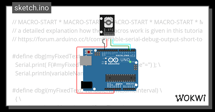

Here is exactly your code. Exactly in the sense of exact same logic but with additional debug-output that makes visible what you code is doing.
Here is a WOKWI-Simulation of your code
best regards Stefan

I have created an online-simulation of your code.
you shoud run ths simulation to see what your code-logic does so far.
Seeing printed what your code is doing should give you new ideas
what you have to change in your code.
