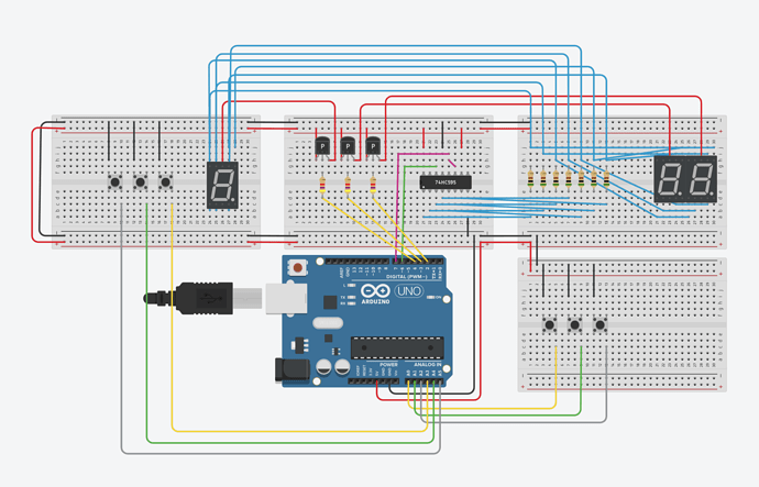

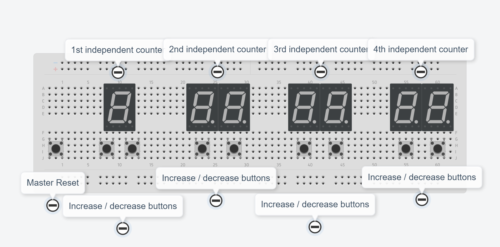

Im working with a little project to create some 7 segment displays. Overall there will be 4 or 5 one or two digit displays doing some very basic counting tasks.
Ive got the two segment display working after adjusting some code i found online and it works perfectly.
I'm now at the stage where i want to add the second one segment display.
My main question is can i get this to work using the same shift register and outputs on the Arduino or will i need another set of outputs and shift register?
Here's a diagram of what im trying to do..... The display on the right works perfectly.
The one on the left is the one i need to get working with the additional buttons.
The idea being i want to add a few more to this as well so it needs to be scalable.

How do i modify the loop to control the 2 displays separately?
Once i know how to do it for one i can crack on and do it for others myself.

Looking online at the configurations for these most seem to come in 2 x 4 7 seg display configurations inc the driver, im guessing you can break out the display configurations into what ever you like after the chip so my layout above would be fine?
Yes, any combination of single, dual, triple or quad digit displays you like. Max7219 can drive up to 8 digits and ht16k33 up to 16 digits.
However, while you can use common anode displays, both chips are designed for common cathode displays. Some of their convenient features won't be available if you use common anode, which might make you code less simple, and with the ht16k33 I think the max 16 digits can only be reached with common cathode, otherwise the limit is 8 digits.
basically yes. either you use bare bone ICs and make your own PCB (the MAX7219 is available in DIL) or you could chose this premade PCBs. The MAX7219 modules with green PCB come mostly with sockets, so you can pull out the two 4digit displays very easily and use "single" digit displays also. As already mentioned - these ICs are best used with Common Cathode.
I would just use the displays as they come, so the MAX7219 in groups of 4 digits and the HT16K33 in groups of 2 digits (although unsoldering these modules might need a calm hand ... I would just use them as 4digit modules). If you stil want to wire your exact 1 / 2 / 2 digits ... the HT16K33 is SMD only, but you will find also breakout boards (without LEDs).

I dont want the 2x4 config as that doesnt really fit into the design. ill have to customise that a bit but that should be fairly easy its just more wires/tracks rather than being neat and tidy in one unit :slight_smile:

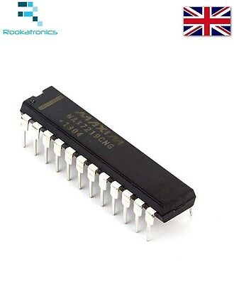

Many thanks guys, ive ordered myself an all in once max for now so i can prove my code out on the display as it was cheap.
Once thats done ill look into the logistics of using the ICs and the display configs i want.

Just wanted to say thanks for the heads up on the Max7219. @PaulRB @noiasca
Got one here at home now, redid my code and this is doing everything I wanted.

when I read this:
I assume that:
displayone = displayone + 5; // increase score
Ill give it a try thanks @noiasca
i did this....
    if (!digitalRead(switchtwo)) {
    displaytwo++;
      displaytwo++;
          displaytwo++;
              displaytwo++;
                  displaytwo++;
    rightdigit=displaytwo%10;
    leftdigit=displaytwo%100/10;
which does work but is messy code! ha!
Confrimed all working @noiasca my messy code can now be removed :smiley:
you should have tried this:
Lots of mess yet to remove!
Suggest you learn to use arrays. Any variables or constants that have a number in their name, such as "switchfour" or "downtwo" should probably be elements of arrays. With this technique you should be able to reduce the length of your code by a factor of 4, or almost that.
So
// Variable to hold current scores
int displayone=0;
int displaytwo=0;
int displaythree=0;
int displayfour=0;
becomes
int display[4] = {0, 0, 0, 0};
and
// Switches pin connection to Arduino UNO
#define switchone 2
#define switchtwo 3
#define switchthree 4
#define switchfour 5
#define masterreset A1
#define downone 7
#define downtwo 8
#define downthree 9
#define downfour 10
becomes
const byte switch[4] = { 2, 3, 4, 5 };
const byte down[4] = { 7, 8, 9, 10 };
and
  pinMode(switchone,INPUT_PULLUP);
  pinMode(switchtwo,INPUT_PULLUP);
  pinMode(switchthree,INPUT_PULLUP);
  pinMode(switchfour,INPUT_PULLUP);
  pinMode(masterreset,INPUT_PULLUP);
  pinMode(downone,INPUT_PULLUP);
  pinMode(downtwo,INPUT_PULLUP);
  pinMode(downthree,INPUT_PULLUP);
  pinMode(downfour,INPUT_PULLUP);
becomes
  for (byte s = 0; s < 4; s++) {
    pinMode(switch[s],INPUT_PULLUP);
    pinMode(down[s],INPUT_PULLUP);
@PheonixUK
if you rearange you variables you might see, that each counter consists of two pins, a counter variable and specific place on the display. So you should consider to put your data into a structure. Furthermore if you check your code - all your counters are doing the same:
reading buttons, increase/decrease counter and print something to the display.
These actions can be brought into one class. You just make 4 "objects" of counters.
At the end, you can reduce your sketch by over 100 lines of code and the loop is just a four liner.
This should give you an idea how I would start:
/* Arduino 7 Segment MultiCounter
   Using the MAX7219CNG LED Driver
   221 rows 4240/128
   124 rows 3822/144
#include "NoiascaLedControl.h"         // download from: https://werner.rothschopf.net/201904_arduino_ledcontrol_max7219.htm
const byte maxCsPin = 13;              // LED CS or LOAD -  8 CS
const byte maxClkPin = 11;             // CLK on UNO/NANO - 52 MEGA
const byte maxDataPin = 12;            // MOSI on UNO/NANO - 51 MEGA
const byte noOfModules = 1;
LedControl lc = LedControl  (maxDataPin, maxClkPin, maxCsPin, noOfModules);  // Software Bitbang - use this if you can't use Hardware SPI
constexpr byte switchone = 2;
constexpr byte switchtwo = 3;
constexpr byte switchthree = 4;
constexpr byte switchfour = 5;
constexpr byte masterreset = A1;
constexpr byte downone = 7;
constexpr byte downtwo = 8;
constexpr byte downthree = 9;
constexpr byte downfour = 10;
class Counter {
    byte steps = 5;           // steps for up/down
    const byte upPin;         // pin increase
    const byte downPin;       // pin decrease
    const byte startpos;      // start position on display
    const byte digits;        // 1 or two digits
    byte score = 0;           // the current count of this counter
  public:
    Counter (byte upPin, byte downPin, byte startpos, byte digits) :
      upPin{upPin}, downPin{downPin}, startpos{startpos}, digits{digits}
    void begin()
      pinMode(upPin, INPUT_PULLUP);
      pinMode(downPin, INPUT_PULLUP);
      display();
      if (digits == 1) steps = 1;
    void up()  // increase counter
      if (digits == 1)
        if (score < (byte)(9 - steps)) score += steps;
        if (score < (byte)(99 - steps)) score += steps;
    void down()
      if (score > steps) score -= steps; // decrease counter
    void reset()
      score = 0;
      display();
    void display()
      lc.setCursor(startpos);
      if (digits == 1)
        lc.print(score % 10);
        if (score < 10) lc.print(" ");
        lc.print(score % 100);
    void update()                          // read buttons and increase/decrease counter
      if (digitalRead(upPin) == LOW)
        up();
        display();
        delay(50); // dirty debounce
      if (digitalRead(downPin) == LOW)
        down();
        display();
Counter counter[] {
  {switchone, downone, 0, 1},  // initialize the first counter with pins, start position on display and used digits
  {switchtwo, downtwo, 2, 2},
  {switchthree, downthree, 4, 2},
  {switchfour, downfour, 6, 2},
  pinMode(masterreset, INPUT_PULLUP);
  lc.begin();
  lc.shutdown(0, false); // Wake up MAX7219
  lc.setIntensity(0, 7);
  lc.clearDisplay(0);
  for (auto &i : counter)
    i.begin();
    i.display();
  for (auto &i : counter) i.update();      // call each object to let its buttons checked
  if (digitalRead(masterreset) == LOW) {
    for (auto &i : counter) i.reset();
