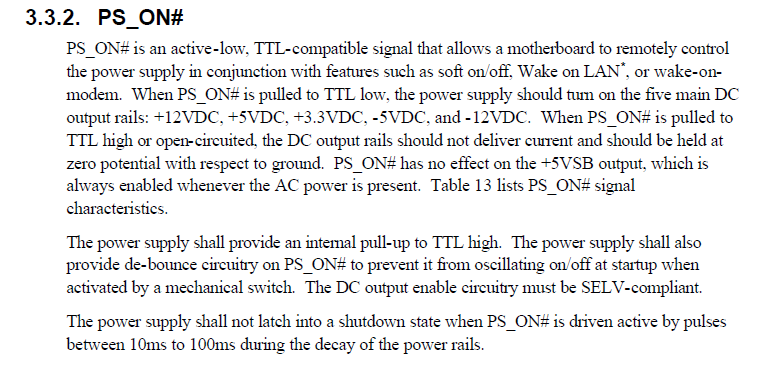

For more details of the requirements of the PS_ON# signal see the Intel ATX12V Power Supply Design Guide.
The PS_ON# signal is the green wire on the main power connector. You connect it to any of the black COM wires to turn the PSU on/off.
ATX Main Power Connector
Table 13 PS_ON#
