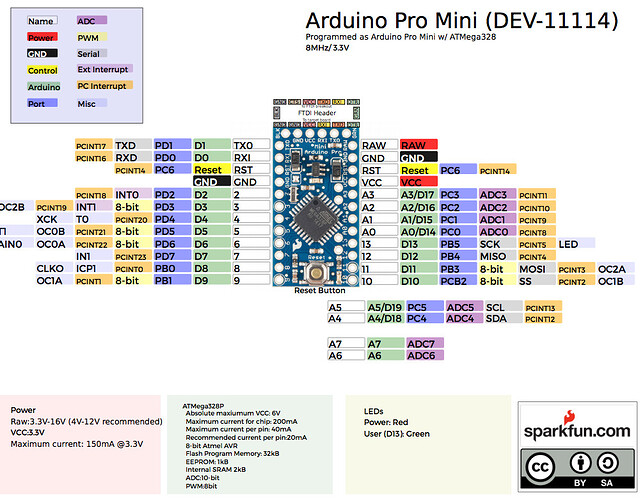

The Pro Mini comes with 14 digital I/O pins plus 4 external (8 in total) analog input pins; 2 of the analog pins (A6, A7) can be used as analog inputs only, but the remaining 6 analog pins can be used as digital I/O!
(4 analog pins are at the edge of the board, 4 can be found on the board close to the Atmel chip incl. A6, A7, which both might not be of importance for your application anyway - provided you are not going to use analog signals, but pure digital ones).
So I think you got plenty of input/output pins for your project, as the stepper drivers just will occupy 3 * 2 = 6 pins. You got a leftover of (14+6)-6 = 14 input pins.
Be aware that this Pro Mini comes in 2 versions: 5V/16MHz and 3.3V/8MHz and there are some Chinese clones with slightly different pinout on the market.
Find attached a pinout diagram of the Pro Mini:

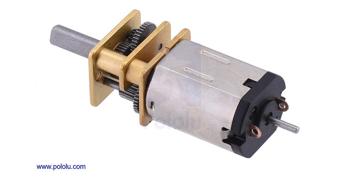

  1. The motors that I've been looking at are the micro metal gearmotors from Pololu, for example:
These require 1.6A at stall, and the DRV8835 drivers only provide a peak of 1.5A. However, I've been looking at the DRV8833 drivers which are similar but provide a peak of 2A, which would fit the criteria.
I am open to using three DRV8833 drivers if it would be a significant difference over using two DRV8835 and one DRV8833 drivers. Please advise on which configuration would be preferable. A link to the DRV8833 drivers can be found below:

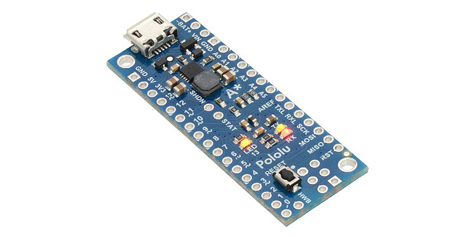

Would this A-Star 32U4 microcontroller be a potential solution? It seems to have 26 pins, 7 of which can be used for PWM, and 12 that can be used as analog.

I would prefer to use as few motor drivers as possible, which is why I'm going for the dual models. This is from space limitations in the palm, as the actuators already take up a great deal of space as it is, and I haven't even tried to fit a battery pack in yet.

  1. Looking at the current data - you will be better off with the drv8833 (in addition to higher current delivery this driver doesn't need extra logical voltage from the Arduino = one connection per driver saved).
I can't really tell you if this MCU is the right solution for you; it all depends how many control pins will be needed at the end of a day. If the number of pins are sufficient for the final solution, this MCU might be the right one for you. Another solution would be to use two Pro Minis which could then share the task; maybe one is dealing with all inputs and functions as master controller and the second one is the slave and deals with the motor outputs. Just a rough idea, not yet thought through.
