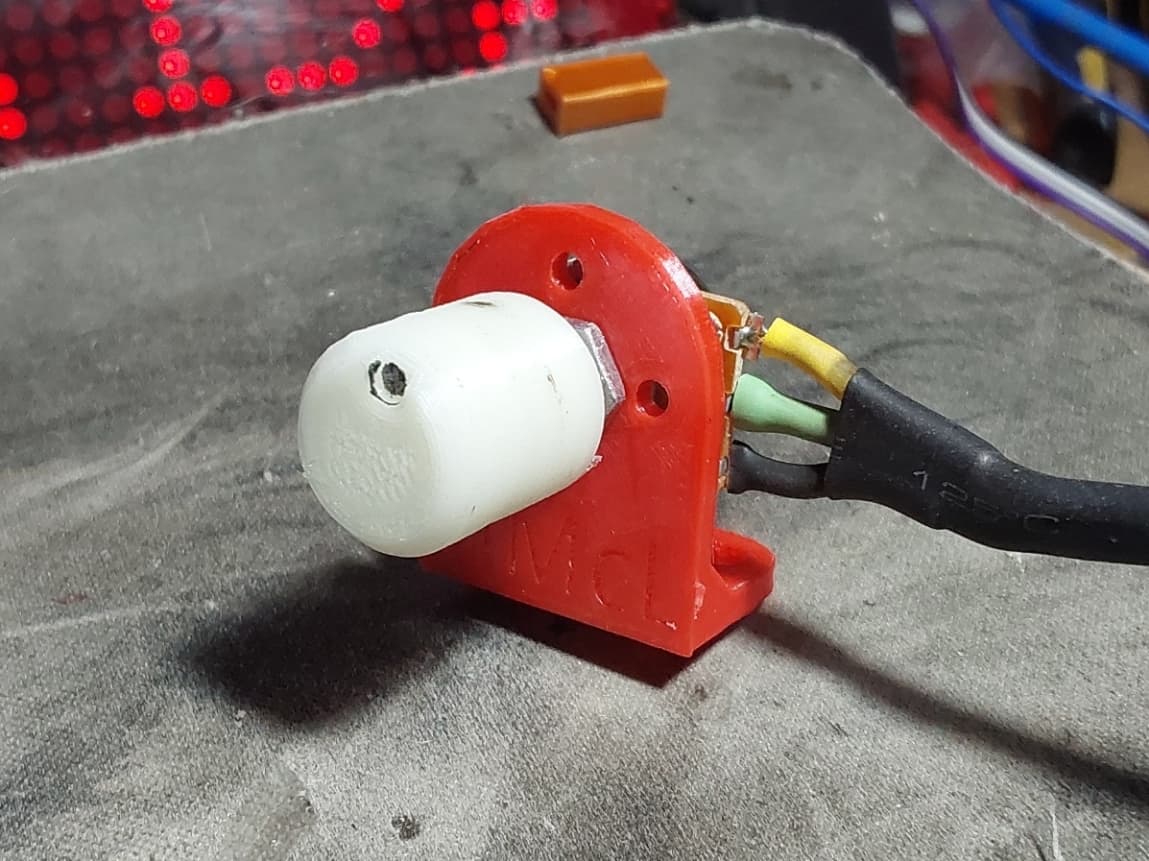

I am trying to control my pump's speed using a potentiometer however idk how to connect the potentiometer to the circuit, below is the circuit I used and the code I have so far, please help!!

Potentiometer has three terminals. Hi - connect to +5, lo - connect to Gnd, and (center) wiper - connect to AI. Value will read from 0, full left if wired correctly, to 1023 at full right.
This value can be scaled or used directly to control whatever speed mechanism you're using.

Basic test sketch.
Leo..
const byte pumpPin = 5; // pin 5, not pump 5
  pinMode (pumpPin, OUTPUT);
  analogWrite (pumpPin, analogRead(A0) >> 2); // write to pump what has been read on A0 and converted from 10 to 8-bit (0-1023 to 0-255)

Hi, @karimtamer2
Can you post a proper circuit diagram plase, not a Fritzy picture?
An image of a hand draw circuit would be fine, please include all power supplies, component names and pin labels.
A picture of your project would also help.
What is the spec/data of your pump?
