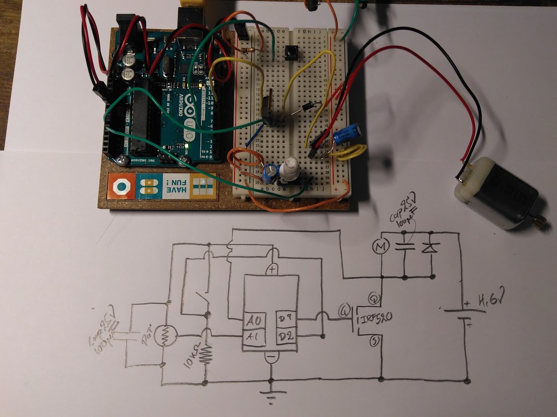

The Pot is wired directly onto + rail and ground rail ( not onto the Motor circuit itself). Potentiometer is wired like pictured on page 64 in the startkit book, and the Pot sensor wire to A1. the A1 is programmed as an "analogRead". The serial monitor can then display the values on A1, from 0 - 1023. The Program directs the A1 10bit analog signal to D9, digitalWrite, that feeds the MOSFET gate port.
I then saw that the motor started between A1 values 0-255, then stopped, on values above 255, it stared again, and then stopped on 512, then started again , toward 1023, then stopped on the max level ! Therefore I mapped the A1, AnalogRead value onto 0 - 255, so the motor didnt stop, as I cranked the pot.

For the initial inquirery of Gosbrut. I was also surprised that I could level up and down the GATE voltage and the motor responded gradually increasing in speed. I thought the Transistor were like ON or OFF. And it is more or less, the motor changes speed slightly .
I also found out that the 10 bit analogRead reads 0 at 0 Volts and 1023 at about 4.6V. So having a 9V DC supply as said in the instruction is out of measure fro the UNO board ...
( I accidentally applied 9V * 3A onto the transistor and had the Diode backwards, the MOSFET was smokin , hahaha. but it survived . )
