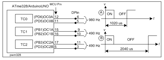

Your sketch is slightly corrected. Upload it and observe the behavior of the motor; it should be better.
byte potin;
int pot;
  pot = analogRead(A0);
  potin = map(pot, 0, 1023, 0 , 255);
  analogWrite(11, potin);
pwm328
Figure-1: PWM pins of UNO board, which can be driven by analogWrite() function
  analogWrite(11, analogRead(A0) / 4);

1. There are two arguments in the analogWrite(arg1, arg2); function. The first argument (arg1) refers to one of the PWM pins (6, 5, 9, 0, 11, 3) as indicated in Fig-1 of post #5.
2. The 2nd argument (arg2) refers to the 8-bit unsigned value (0 to 255 in decimal base = 0x00 - 0xFF in hex base) which determines the duty cycle (ON-time) of the PWM signal.
3. You want to control the duty cycle taking value form A0-channel of the ADC in the following way:
unsigned int adcValue = ananlogRead(A0);
4. The value of adcValue is 16-bit (upper 6-bit always 0s and lower 10-bit comes from ADC); whreas, the agr2 of ananlogWrite() feuntion is 8-bit. Therefore, we have to compress the 16-bit (max: 1023) value to 8-bit (max: 255). This compression is done using the following function:
byte arg2 = map(adcValue, 0, 1023, 0, 255);
5. Now, the codes are:
byte dutyCycle = map(adcValue, 0, 1023, 0, 255);
ananlogWrite(11, dutyCycle);
6. The above three lines can be written by the following single line code called embedded/nested form:
ananlogWrite(11, map(analogRead(A0), 0, 1023, 0, 255));
7. As 255 is almost = 1/4th of 1023 (= 255.75), the code of Step-6 can be written
as (@anon73444976):
analogWrite(11, ananlogRead(A0)/4);
