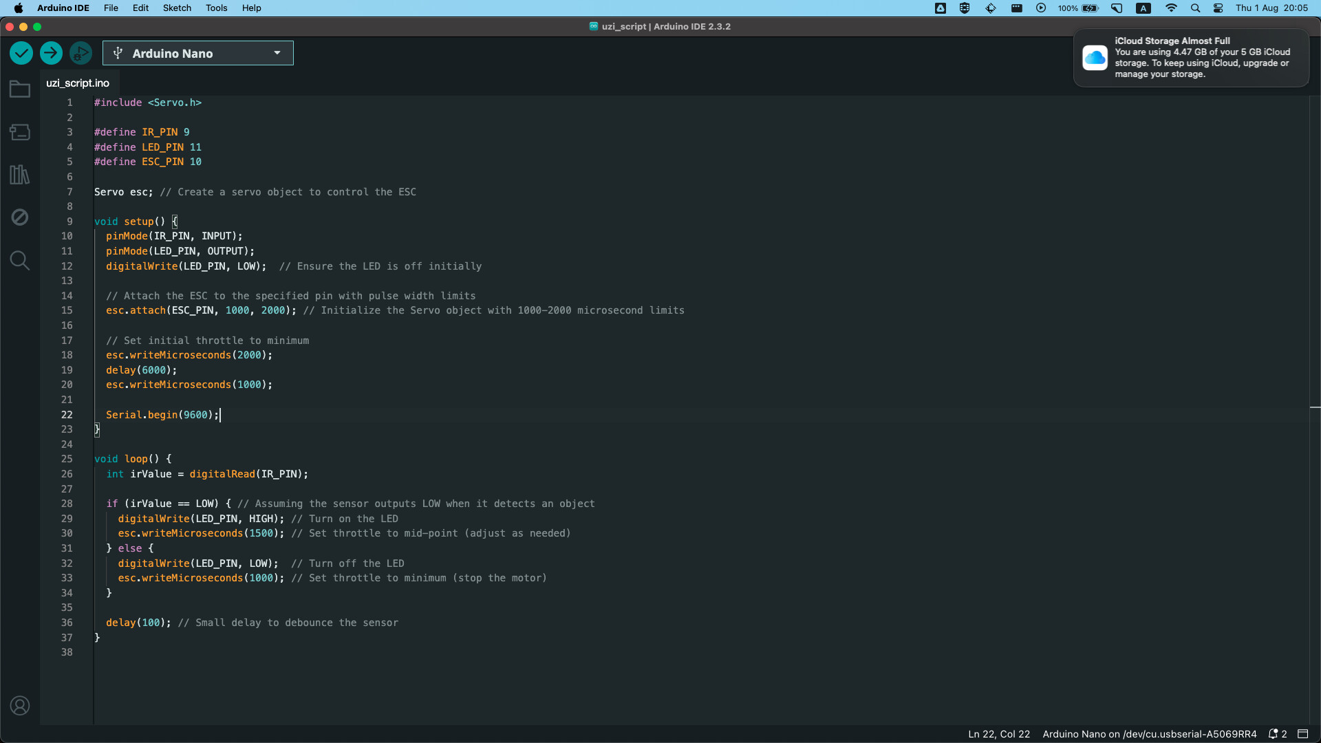

I'm trying to get my Arduino Nano (ATmega328P - old bootloader) to control a Turnigy Plush ESC (Electronic Speed Controller) for an RC plane brushless motor.
Once the ESC is powered, it makes the motor beep until a signal of 0 throttle is received, indicating that it's safe to control the motor. My issue is that I can't get the Arduino to send the correct signal to the ESC to allow control.
I've tried different PWM values for the signal input going into the ESC, but I haven't been able to get it to work.
Iv'e tried different PWM values but the ESC continues to beep and doesn’t allow motor control. I’ve ensured the ESC is powered correctly and the connections are secure.
Any advice or suggestions on how to get the ESC to recognize the signal and allow motor control would be greatly appreciated.

You' need to limit the pulse width to 1000...2000 ms and initialize the Servo object with 1000ms width ( or ...write(0) ), like so:
Servo esc;
  esc.attach(THE_OUTPUT_PIN, 1000, 2000);
  // either all in ms:
  esc.writeMicroseconds(1000);
  // or from 0...180:
  esc.write(0);

Calibration sequence (in setup()) - adjust delay as needed. Sequence is needed only once in the lifetime of the ESC (but you'd do it way more often):
delay(3000);
do you mean?
esc.writeMicroseconds(2000);
delay(3000);

That 10 second delay seems overly long. Try sending a throttle stick max signal as @bitherder_57 says before the three second mark on power up, then send the 1000uS signal after 3.2 or so seconds. Even better, on startup send a ramping down signal from 1000-700uS or even just lower the startup signal to 700uS.
hey guys
i try the following with different min throttle values but the ESC won't start
should i take the RC transmitter and receiver to someone with oscilloscope to read the throttle signal coming out the receiver so I can adjust the code base on the reading?

Anyway, you could try:
delay(3000);
delay(3000);
for(;;) delay(3000);
You should hear a beep after esc.writeMicroseconds(2000); and you must power off the ESC after some seconds (and the arduino). The calibration is a onetime thing to do, so remove it from the code if it succeeds.
