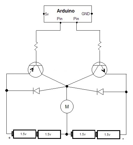

I thought about using relays, but that would result in a clunky and clickety-noisy design. So, since I'd likely have to use transistors anyway to control relays using a Nano, I decided to go with an all-transistor design, basically a custom-built H-Bridge. Here is the design I came up with:
OWI - OWI-535 Robotic Arm Edge - Schematic - Single Motor - Transistors - Single Pin.jpg
The idea was to employ tristate logic, such that when the Nano pin was set to Input_Pullup, nothing happened, corresponding to motor off, and when the pin was set to Output, a 0 turned the motor one way, and a 1 the other way.
However, when I tested it, it didn't quite work the way I'd hoped. I actually tested it without an Arduino, connecting the "pin" lead to either Ground, 6V, or floating, to correspond to the above 3 states. When connected to Ground or 6V, the motor did indeed turn one way or the other. But when the pin floated, the motor still turned, albeit much more slowly.
As some of you have probably figured out by now, the reason was that the bases of the 2 transistors were bridged by way of the 2 pin resistors (each 10K), so enough current was leaking from the base of the PNP to the base of the NPN to allow enough current to flow through the NPN to slowly turn the motor.
The obvious solution to this is to use 2 Arduino pins, one for each transistor and motor direction, with both pins set to 1 to turn the motor one way, both set to 0 to turn it the other way, the left pin set to 1 and the right pin set to 0 to stop it, and the left-0 and right-1 setting never used (with a delay in the code to avoid it even in passing):
OWI - OWI-535 Robotic Arm Edge - Schematic - Single Motor - Transistors - Two Pins.jpg
However, I was hoping to use just 1 pin per motor, because it seemed like a more elegant way to do this, using tristate logic. But I'm not sure how to make this design work that way. Is there any way to do this, say, by using higher-value resistors, or inserting a diode or two elsewhere in the circuit, or another transistor (which, admittedly, would make it no longer simple or elegant)?
Anything else wrong with this design, or that could benefit from modifications?
Also, what should I connect the Arduino's Ground pin to, the rightmost "-" on the battery, or the midpoint that the motor's other lead is connected to?
And yes, I realize that I could use an H-Bridge chip such as a 293D instead, and in fact that was my initial design, which worked. But it would require a bit of rewiring on the robot arm, and I wanted a solution that could be plugged into its cable pins directly and not require any changes to the robot arm unit.
Thanks in advance!

A pulled up pin is not tri stated, it's connected to +5V through a high value resistor, drop the "PULLUP", how is Arduino's GND (signal return path) connected? Be careful of negative voltages on the pins.
edgemoron:
Thanks for the tip. I looked at the Arduino reference and saw that plain old INPUT (as opposed to INPUT_PULLUP) is very high impedance, and thus allows true tristate.
However, in this state, since the bases of each transistor are bridged via resistors, isn't it possible for enough current to leak from the base of the PNP on the left to the base of the NPN on the right, to activate one or both transistors and turn the motor, slowly, in the direction of the greater net voltage--or, if they're basically equal, burn out one or both transistors and maybe the motor? (I'm referring to the first, single pin design here.)
As for the Arduino's GND, I'm connecting it to -6V, on the very bottom right of the schematic above, where the minus sign is. Should it instead be connected to the middle bottom pin where the 4 D's are split?
