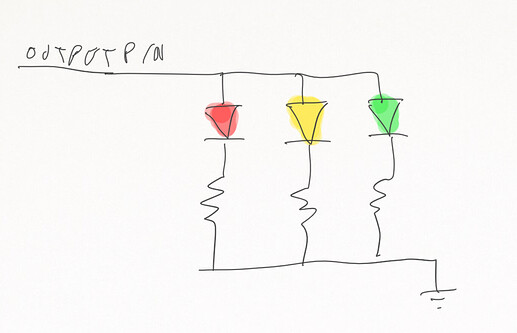

I'm trying to design and control several LEDs in the following configuration:
  1. 4 LEDs fading
  2. 2 LEDs blinking
  3. 4 LEDs steady ON
All the LEDs are SMD, some are 2-2.2V and some 3-3.3V in different colors.
All the LEDs are connected parallel and each group (1-3) to a different digital output.
The issue I'm having looks like lack of current - when group 3 works - groups 1-2 doesn't have enough current to be operated.
What you think the problem is?
In addition - how can I use the Arduino as a PLC? I can control the output pins with 5v but supply the current from a diffrent source.
Thank you
Guy

Do you have resistors on each individual LED?
Please post the code, formatted and in code tags.
Yes, each led has its resistors
Use logic level MOSFETs or Transistors.
Can you explain? Maybe a YouTube explanation?
I'm new to Arduino but have lots of experience with PLC so I'm trying to mimic the same logic of using relays - maybe this is the solution.

I'm new to Arduino but have lots of experience in PLC programing, therefore the below scheme will resemble a PLC architecture.
The project is 11 SMDs 0805 20mA LEDs in 4 groups. Each group has its own On/Off toggle switch.
The main goal is to have all LEDs working on demand (all or some) while some are blinking, some are fading in and out and the rest are working on continuously.
I have an Arduino Nano and Uno, 9v (Alkaline) and 12v (LiPo) batteries to use to power all up.
Wiring using 30awg enamel magnet wires - for LEDs.
Green and White LEDs are 3-3.2v while the Red LEDs are 2-2.2v.
My questions are:
  • Does this project feasible as an Arduino project?
  • Do I must use resistores for each LED or can I use a volatge stepdown for each group of LEDs with the same voltage input?
  • I did a test today with 3*10kOhm resistores to reduce 5v,5A to 3v and the White LED wasn't bright enoutgh in comapre to a 3v,5A in direct input (I guess V=IR worked here)
  • What about current consumption? How can I control it?
  • Can I combine LEDs with the same working condition or I must use each LED in diffrent digital output?
Project architecture is attached
Thank you all for your help.
Guy.
Which Nano are You using? There might be several different ones. Find out max I/O voltage it has, 3.3 or 5 volt.
You can't use resistors to create controller power. Use a stepdown converter making the Vcc for the controller.
Each LED must have a serie resistor controlling the LED current. If the LED powering voltage is higher than I/O pin max voltage, drivers are needed.
Yes it is feasible.
1 Resistors for each group of series LEDs
1 Resistor for individual LEDs
No parallel LEDs
Check the current ratings of the LEDs, that controls brightness.

Can you explain more about connecting the LEDs groups? Which resistors I need?
In each group the LEDs will be connected in series and the resistor will be connected in parallel to each group?
What about the outputs? One output to each group?
Mix ms match.
Each LED needs its own resistor to control the current. Use each LED's forward voltage specification to determine the resistor for the current you want.
Modern LEDs can be bright at very small currents. Try 5, 10 and 20 mA to see how your LEDs look. Most can tolerate 20 mA, but check that before seeing if.
You can attach several at one output pin.
But you must not exceed the maximum allowed current on the pin, or the port the pin is part of, or the microprocessor chip itslef, three different current limits.
If you need more current, a simple transistor or MOSFET circuit can control all the power you need, just don't draw that power off the Arduino board.
HTH

There is any way I can use Arduino as a PLC?
Meaning to control a set of relays while the current is drawn from an external source (not from the Arduino board) and the arduino is only the "brain" with gives the relay the command to close or open its contactors.
I really don't have any experience with electronics such MOSFETs and resistors.. the maximum is to solder and build drones electronics.. not to design the circuits.
If you can make a quick diagram of your idea of how I can control all the LEDs in the diagram in my original post it will be a huge help!
Thanks!
Sketch your LED's, group them and post them, then we can get into the circuit. You can put them in series but they will all light at the same time, this would require 1 resistor per led string. Add up the Vf of each led in the string, subtract that from your supply voltage, then use OHM's calculator and determine the resistor value. As long as the current is below 20 mA you will be OK. The resistor value will determine the current and the brightness. The higher the brightness the dimmer the LED. Individual controllable LED's need to each have its own resistor as shown by alto777.
