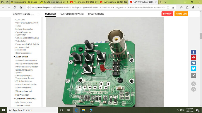

hello all I tried for hours to search online on how to control an analogue zoom camera that is why I posted here, I want to buy one of two types of analogue cameras available at affordable price to use them with wirless video tx now connecting to video tx is straight forward video ground you are good to go, but how to control the zoom and focus is the issue! the interface as both cameras are the same principle but different zoom (10x or 30x) the interface is rs485 and the protocol is pelco-d , if some one can please supply a link or post on what to do for some one that has done this and it worked successfully for him, thanks in advance!

this is a link to the camera 10x in description connections are mentioned
and this is another image of 10x cam
