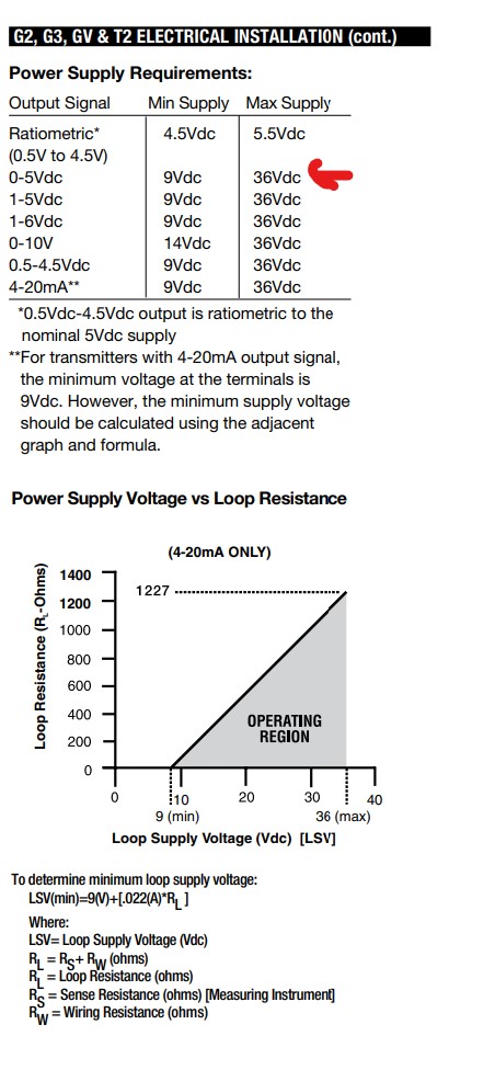

Can You post a link to the datasheet? Your commented code is not in harmony with the picture data.

I used this code with the transducer I have, but it shows me 0psi, it does not read at all! Is it because of the code or the transducer could be damaged?

I did as you mentioned then I got around 86 psi in the serial monitor. After that, I connected the sensor to the Arduino (red cable to 3.3v, black to ground, white to A0)
When I connected the sensor to 5v it shows only 0 but with 3.3v it shows reading!

The image in the first post indicates the sensor should be powered with 9-36v.
Here is a link to the G2 data sheet. Can you confirm which model you have?
https://www.ashcroft.com/wp-content/uploads/2020/09/datasheet-g2-pressuretransducer.pdf
I'm using this model
