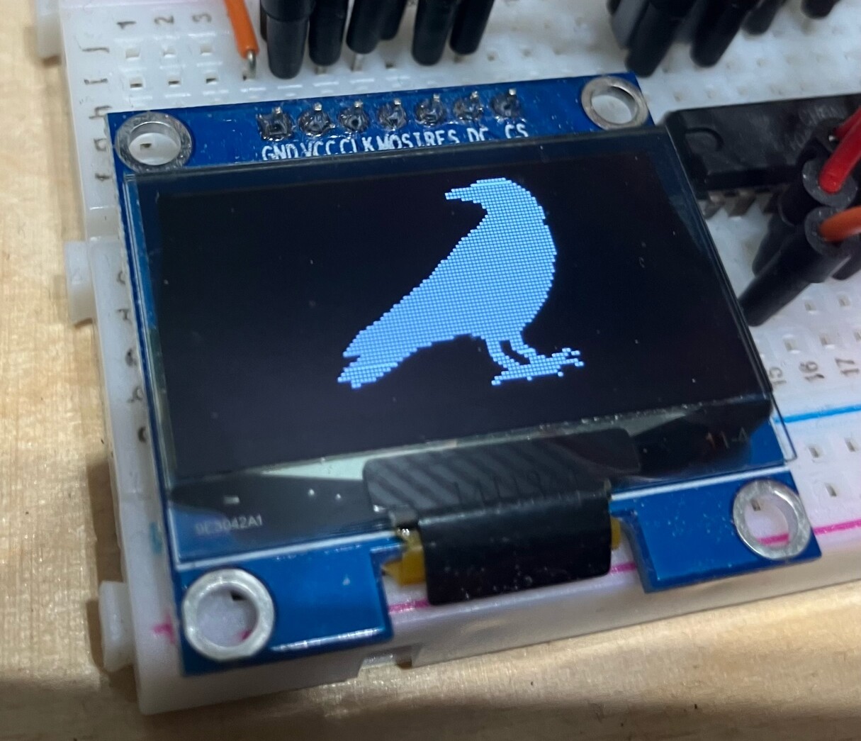

I have a png-File with 512x512 pixel size. Now I'm desperately looking for a tool that does both converting the size (e.g. 64x64 or smaller, i.e. selectable) and provides the result as (C++) - array, which I can later include into my code. Once I have it, u8g2-Library will do the job to show the grafic on the display ... at least, this is the plan.
Does anybody have a good hint for this? Thanks for your support.

Which display are you using? U8g2 is generally used for monochrome displays.
Have you tried converting to XBM format? That literally produces c-code, and U8g2 has commands to draw this format. You will need to save this file and change the extension to .xbm, the website will not allow me to upload it directly.

No, but meanwhile I did. At the end the working solution even though not every PNG-to-XBM converter is working (the one that did the job is linked below)
My workflow ended up in doing this:
  1. Resizing *.png using IrfanView
  2. Convert *.png to *.xbm using this URL
  3. Checked the result using this xbm-Viewer
And did some iterations until I got it runing using PROGMEN. Which was my fault - the documentation of u8g2-Library is saying it correctly, but I missed the detail ... (see comment in code below)

U8G2_SH1106_128X64_WINSTAR_1_4W_HW_SPI u8g2(U8G2_R2, 10, 9, 8);
// The raven itself
#define raven_width 64
#define raven_height 64
static const byte raven_bits[] U8X8_PROGMEM = {

  do {
    // Logo - HERE: use u8g2.drawXBMP .. with the 'P' when array is stored in P(!)ROGMEM
    u8g2.drawXBMP((displayWidth - raven_width)/2 , 0, raven_width, raven_height, raven_bits);
  } while ( u8g2.nextPage() );
  while(1);
And the bird itself
I use the GNU Image Manipulation Program, https://www.gimp.org/. That will do the resizing (scale the image) and export to XBM (X Bitmap) format. Does have one slight problem, the array in the xbm is declared as "unsigned char", which needs to be changed to "byte" to match the drawXBMP() function.
