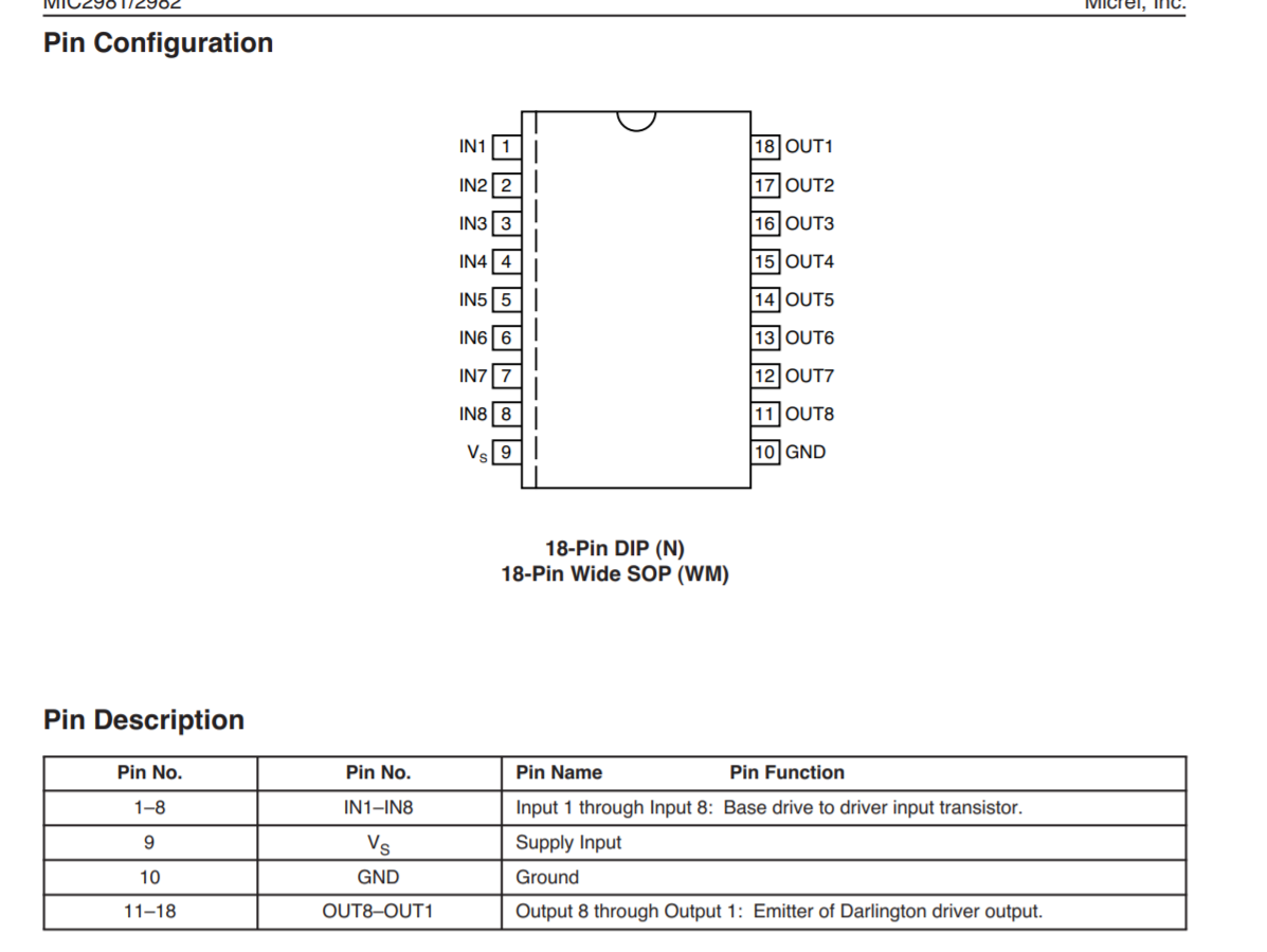

Probably the simplest one chip solution is the MIC2981 https://www.mouser.ch/datasheet/2/268/mic2981-1891019.pdf

Source side drivers are ideal for this application. The only problem is these are difficult to get hold of. The one I quoted in post #4 , the MIC2981, is available from Mouser. The TD62783 which you mentioned appears more difficult to get hold of.

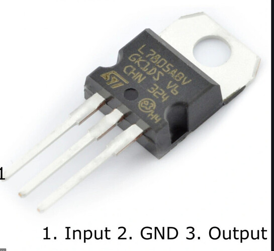

Instead of the 24 to 12 volt buck converter, I would use a 24 to 5 volt converter. Power all the 5 volt peripherals (Relays, LCD etc.) directly from that. But where does the 24 volts come from ? If that is a boost converter 5 to 24 volts, maybe you could derive your 5 volts there instead.

But is it that easy that in that case:
IN1-IN8 signals from digital outputs from Due 0/3,3V
Vs= 24V
GND = GND (connected to the arduino GND ? )
Then OUT1=OUT8:
OUT1 will be high (24V) when IN1 is high 3,3V ?
No need for extra resistors/capacitors and no problem with high current?
Difficult to get hold of. Meaning: difficult to obtain from a regular supplier. The MIC2981, even in DIP format (easier for a prototype board), is still available at Mouser.com. If you see a better one or one which is easier to obtain where you are, then use that instead.
The mic2981 uses positive logic. 3.3 volts (or a bit less) on an input pin gives the high voltage (in your case 24 volts) on the corresponding output pin. It does not need any additional resistors. However, on the output, I might consider using 100k pull down resistors as a precaution against leakage.
So the connection I wrote in the previous post #15 is correct ?
Yes. The pin connections look correct according to the data sheet.
