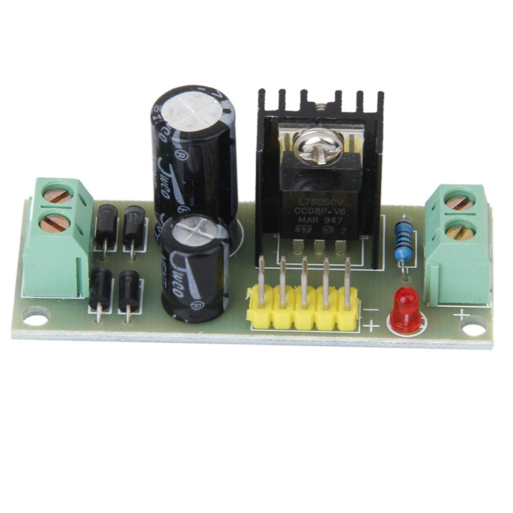

For a smart doorbell project, I'm considering using a uninterrupted 8VAC supply to provide power to a SoC module and some relays.
A quick google came up with this:
https://www.ebay.co.uk/itm/L7805-AC-DC-DC-Step-down-Regulator-Power-Supply-Module-7V-36VDC-6-27VAC-to-5VDC/232022503091
Which seems to do the trick, but uses an L7805. Is this the best way to achieve what I need? I ask because I read that it's pretty inefficient. As an alternative I also spotted this:
https://www.ebay.co.uk/itm/AC-DC-Buck-Step-down-Voltage-Converter-3-3V-5V-6V-9V-12V-Rectifier-Filter-Module/253333543363
But partly as a learning exercise, I'm wondering if I can do better by building my own, based on this:
However I'm having some difficulty working out what I'll need.
At 8VAC, the resulting DC will be 8 x 1.414 ~ 11.31 - 1.4 ~10v. I was hoping to just use a buck after this point like this:
But do I still need the various capacitors? If so, how can I work out which ones?
Also can I use 1N4148 for the rectifier bridge?
A simple bridge rectifier, storage capacitor and linear regulator would work OK.
If you want higher efficiency a buck convertor is better, but a 'lashup' on a breadboard will almost certainly not work - the devices involve very fast high current switching and need a carefully designed PCB.
You can buy such premade devices capable of up to an amp or so at 5v very cheaply (~£1 ) on eg eBay, and I suggest you go that way.
You'd still need a rectifier and storage capacitor, of course

Based on your other thread all you want to power is an Arduino so you don't need much current. This 1A buck converter seems to be the ideal solution: plug and play.
If you want to experiment:
Bridge rectifier, gives you a 100 Hz half-sine voltage. Add a big cap (that module you linked to uses a 1000 uF cap) on the output to smooth it, then a linear regulator like indeed the good old 7805 with its own caps (330nF ceramic both sides iirc - check data sheet). That should also give you a rather clean supply.
Such a linear regulator may need a small heat sink; 200 mA is typical for an Uno so that's 0.2 * 5 = 1W of power dissipated.
Not sure what you mean by an "SoC module", but if it's anything like the typical Arduino [this is an Arduino forum, after all], then it probably has a built in, voltage regulator [could be Linear and it could be a Switch Mode Buck Converter].
So, you may be able to get away with rectifying and filtering that 8VAC with a Bridge Rectifier arrangement, and filter capacitor, like in that first link of yours [sans 7805], and just use the Arduino's regulator. Can't advise you further, because you didn't divulge what device you're using.
BUT, it depends on how much current that 8VAC transformer can put out, and what the over all current requirement will be for everything you want to drive [e.g. relays and such]. Also, transformers are notorious for having a higher open circuit voltage than the rated voltage [i.e. the *rated voltage* is at the *rated current*]. So, your 8VAC transformer might run at 8VAC when it's ringing the bell, but when the bell isn't ringing, that voltage could be more like 11VA, or more!
Also, if your application doesn't require much current, then why even be concerned about efficiency? I mean if we're talking about a different of fractions of a penny [assuming your using US currency wherever you are ;)], then what's the fuss?
You might get away with using 1N4148s, but being a beginner, I suggest not adding another failure mode variable and use 1N4004s [or 1N4005 or 1N4006 or 1N4007].
Well, it's late...so more tomorrow...unless someone else wants to take over :smiley:

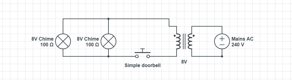

For context here's the current bell:
I've pulled out the multimeter and have found the following for the transformer:
  • The transformer idles at 9V
  • It's a DAT03A which is rated at 2A
  • When the button is pressed the voltage drops to 8.7V.
And for the chimes:
  • The label of the chime says AC 8V ~ 1A
  • The resistance across the AC chime terminals (I tested both also while button was pressed which I assumed shouldn't matter but did it anyway) is around 4 ohm
  • The voltage at across one of the chimes when the button is pressed is around 6.4V
  • I can't seem to measure the current with my multimeter (I later realised it only works with DC), but according to the above it draws around 1.6A (6.4v/4ohm), which sounds pretty high.
So unless my schoolboy testing is in error, it sounds like the transformer shouldn't be able to provide enough current for the two chimes let alone the wemos/relays. Am I missing anything?
Yes.
The supply is AC, so the impedance it sees in the chime depends both on it's dc resistance and it's inductance. I'll assume the AC is a pure sinewave.
  • ie R and 2pi F * L.
Where R is the dc resistance in ohms , F is the frequency of the supply, and L is the inductance in Henries.
I'll call this second ezpression ZL. The complex impedance of the inductive part.Still measured in ohms.... but.
You can't just add these quantities as you would with series resistors , since the current in the inductor has a phase advance of 90 degrees .
The actual expression for the addition is:
Z ( the complex impedance of the R and L in series ) = R + j ZL where j is SQRT(-1).
So you have to add them as two orthogonal vectors - ie
|Z| ( the magnitude of the complex impedance) = SQRT( R^2 + ZL^2))
You can then apply ohms law : I = V/|Z|
The phase angle of the current flowing compared to the applied ac voltage is given by
arctan ( ZL / R )
Allan
The bell is operated by electromagnet, basically a big inductor, current is dominated by the inductance, not
the DC resistance. Apply 8Vdc to the thing and it will carry much larger current and then overheat
and fry itself.
What you tested is the DC resistance. AC resistance, or reactance is the quantity in play. That 100Ω on the label is, likely, the AC resistance at 50 or 60 Hz [depending on your locale]. 8V/100Ω = 800mA which is in the vicinity of 1A. AND, actually, the actual resistive quantity in question, here, is Impedance, which is a Vector summation of both pure resistance and inductive reactance. And, one would expect that 100Ω assessment to be the impedance.
My knowledge of AC is a bit rusty and my knowledge of electromechanical math and physics is just plain lacking, so I have no explanation for the 200mA disparity between the 1A rating and the 800mA math result.
Eeek. That 100Ω is an artifact of the circuit drawing app I used - it was the default and has no basis in reality and my focus at the time was to draw up the circuit. So my lesson learned here is to never be flippant when providing these diagrams. That said, I don't think it changes the conclusions too much so thank you.

sshaikh:
Ten volts in, five out. Wastes as much power as what it feeds, uses. Better not to get things any hotter than you can manage to avoid.

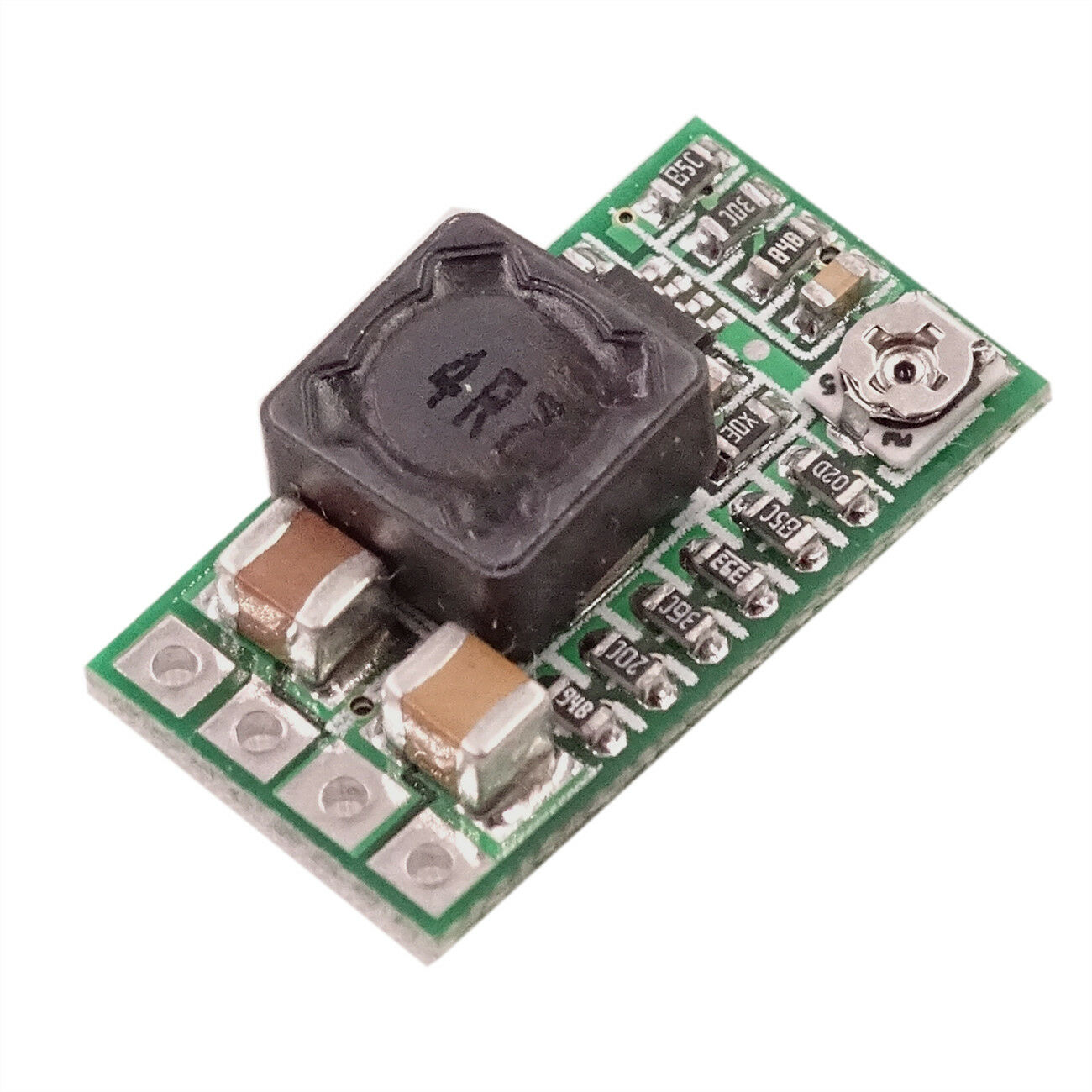

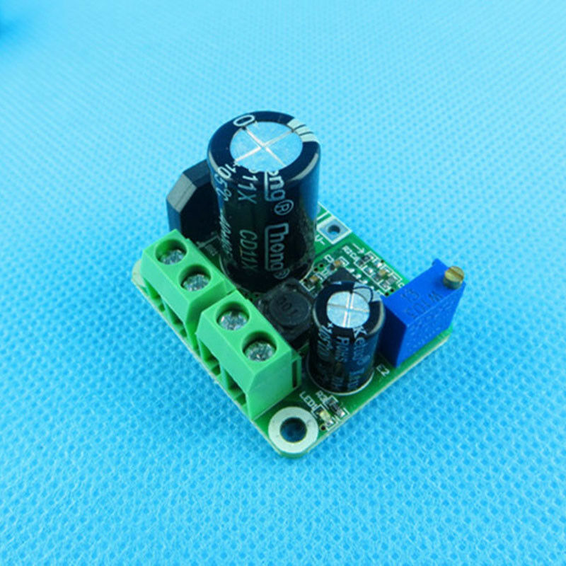

sshaikh:
Includes bridge rectifier, and interestingly, the cheapest of those you cited. Looks good. Can't see the capacitor rating but probably adequate as claimed.
And as others have explained, the inductance in addition, will limit the current to 1 A at 8 V.
sshaikh:
The voltage at across one of the chimes when the button is pressed is around 6.4V[/li][/list]
Given a few more ohms in the wire.
sshaikh:
No, add the inductance, less than 1 A.
sshaikh:
So unless my schoolboy testing is in error, it sounds like the transformer shouldn't be able to provide enough current for the two chimes let alone the WeMOS/ relays. Am I missing anything?
Yep. 1 A each chime, two of them is 2 A, the WeMOS will not draw too much.
