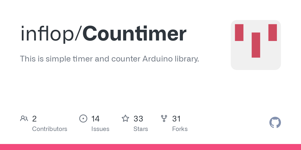

I am trying this library so is there a way to use 0.1 second with it?
did u try timer.setCounter(0, 0, 0.1);
it consider 0.1 as 1 second
can anybody modify library to be set as:
timer.setCounter(hour, minute, second, millisecond);

With this library, you can use milliseconds. From the example code:
    // Print current time every 1s on serial port by calling method refreshClock().
    timer.setInterval(refreshClock, 1000);
So you can change the 1000 to any number of ms that you like.

Then change:
_currentCountTime = ((hours * 3600L) + (minutes * 60L) + seconds) * 1000L;
to this completely untested code:
_currentCountTime = ((hours * 3600L) + (minutes * 60L) + seconds) * 1000L + milliseconds;

That is how it is used in the simple test example. It is not limited in use to only that. If you set it to run the callback every 100 ms., your need can be met. You can do anything reasonable that you like in the callback routine.
You haven't provided any code, or explained at all, what you need the timing for.
It looks to me like the other methods use the interval that is provided, so they might still work, but in deci-seconds (1/10s).
void Countimer::run()
	// timer is running only if is not completed or not stopped.
	if (_isCounterCompleted || _isStopped)
		return;
	if (millis() - _previousMillis >= _interval) {
		if (_countType == COUNT_DOWN)
			countDown();
		else if (_countType == COUNT_UP)
			countUp();
			callback();
		_previousMillis = millis();
You should try changing the interval, I can't test it here due to lack of time.
