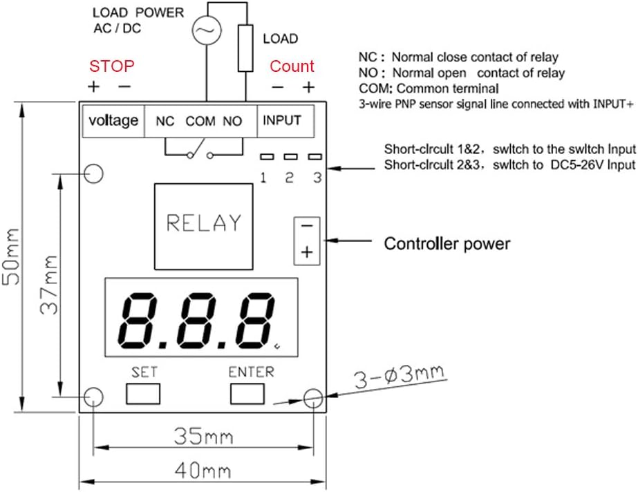

I am using a CT 1.1 Counter Controller Module right now, but it offers no real expandability. I will upload a pic of the module that I am going by.

I got about 75% of that diagram, but it looks like I could figure it out. Not sure what the Heartbeat LED is for...
