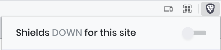

Possible solution:
  • with the "Arduino Create Agent Plugin" install page open
  • click on the Brave shields icon in your URL bar (little red lion face)
  • set shields DOWN for this site. The lion face should turn gray.
That fixed it for me.
I've reported this to the Brave developers; hopefully they'll get it sorted so it works with shields UP soon. In the meantime, we'll have to trust Arduino. :slight_smile:
GEEK DETAILS
If you prefer to be as limited in your permissions as possible, turn on the Advanced view for the Brave shields and then only "Allow all trackers and ads" to enable the required connections. What this allows, which the agent requires, is connections to localhost on a port between 8990 and 9000. Looking through what the site connects to, I didn't see any external connections (non arduino.cc or localhost) to worry about, so this shouldn't be a big concern, even if you're being ultra cautious.
/GEEK DETAILS
