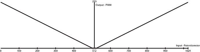

Okay so, I'm really confused about converting the pot value to the speed output. I've attached an image to help what I'm trying to do.
I've got a deadzone of 20 in the middle of the pot, so 502-522 is the deadzone.
When I've got the pot value as 0, I would like the speed to be 255 counter-clockwise, and when I've got the pot value as 502, I would like the speed to be 0 counter-clockwise.
When I've got the pot value as 522, I would like the speed to be 0 clockwise, and when I've got the pot value as 1024, I would like the speed to be 255.
Any help trying to do this would be great!
James

jamesbonner:
Have a look at using the map() function. This will show the principle
int input;
int speed;
  for (input = 0;input <= 502; input++)
    speed = map(input, 0, 502 , 255, 0);

To use it in your program you would use the input value to set the direction pins then feed the input value to the map() function. This will give you an output value to use for the PWM output.
Robin2: Hmm... okay then. I'll just have to experiment with it for a bit, but remembering not to set both pins high at the same time XD
UKHeliBob: So for the map() function, could I use this code (just for one motor):
if(panval < 503) //for the pan motor
    digitalWrite(pan1pin, LOW);
    digitalWrite(pan2pin, HIGH);
    speed = map(panval, 502, 0, 0, 255);
    analogWrite(panPWM, speed);
  else if(panval > 521)
    digitalWrite(pan1pin, HIGH);
    digitalWrite(pan2pin, LOW);
    speed = map(panval, 522, 1023, 0, 255);
James
