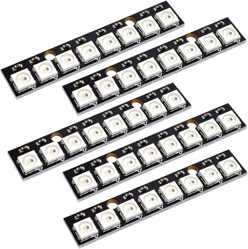

Hello people, I want to create a fuel gauge for my tractor using 2 x 8 Channel fully addressable WS2812B LED Strip

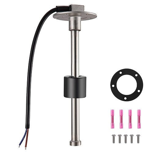

and a Fuel Sender Unit (basically a 190 ohms Variable Resistor)
