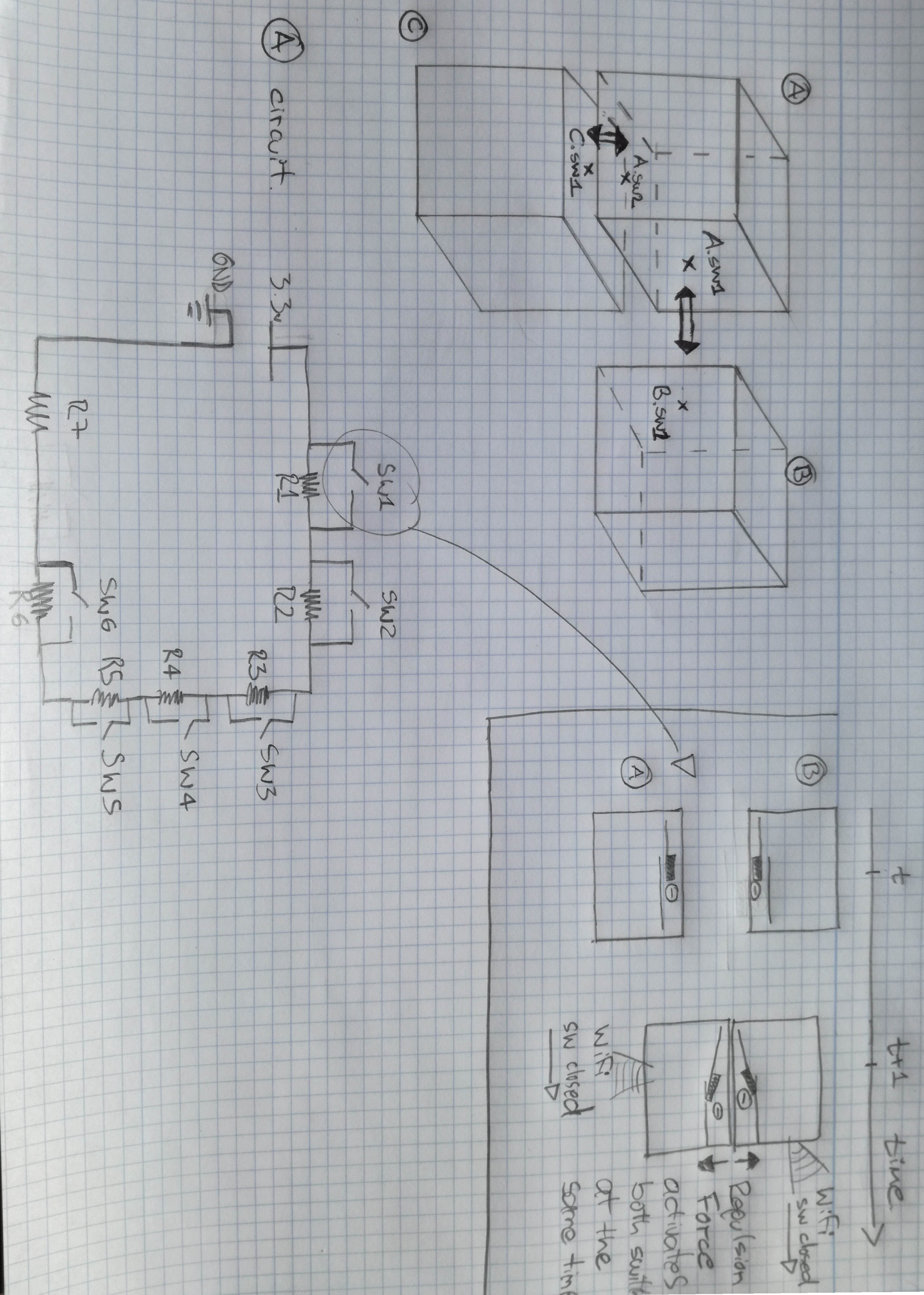

I need to sense when one cube is touching another one. These are the rules:
1- I can just use the only analog input in the ESP-07. This means I only have one analog pin to do the magic.
1- One cube could be joined with other cube by any of the sides.
2- There is no need to detect which is the specific side where another cube was attached, I just need to detect an "attached" event
I have an idea but I can't build it yet, probably because my limited knowledge of electronics. I designed a circuit with 7 resistors and for each resistor a switch that jump the resistor. So, initially all the resistors are "on" , i.e., the switches are opened. When I close a switch I can sense it because there is a voltage drop that I can detect reading A0 (see the file attached!). The big question is, how to close that switches just by proximity!
I hope I had explained myself, any ideas are very welcomed!!!!
Make the switch a reed switch and put a magnet in the other cube. When they are joined the magnet will trigger the switch. You might have to use ore than one switch and magnet to cover the whole of the side of the cube.
Their is no point in all those resistors the way you have wired them because any single closure will produce the same drop. Just wire all of the switches in parallel.
Yes, reed switch. Will do the job.
As added bonus: if you add resistors in series with the reed switch, you can actually even tell which side is touched by the different analog value!
Be aware that the ESP's ADC can read only 0-1V, not 0-3.3V as you may expect.
The easiest is to wire your reed contacts high side in that case.
1k resistor between ADC and GND.
2k3 resistor + reed between Vcc and ADC for the first side (ADC about 1024).
3k for the second side, ADC about 676
4k third side, ADC 520
5k5 fourth side, ADC 375
12k fifth side, ADC 260
24k sixth side, ADC 135
That idea. Use convenient resistor values. First must be at least 2k3 to bring the ADC voltage down to 1V.

circuit-switches-blocks-.jpg ) explaining the circuit and the switches
Grumpy_Mike:
I put 6 resistor with 6 switches in order to detect each side and cover the case where the cube has more than one joined cube (see the drawing attached).

Good, but this only works when we assume that the cube has only one cube joined. What happens when there are many cubes joined to a single one? I.e., when many of the switches are activated at the same time...For sure there is a way to calculate the voltage for each switches combination, but the math there is not that easy... right?
To wrap up, the alternative reed switch in theory is fine, but I'm not yet sure because I'm not sure about the precission I could get from these home made switches. And also the repulsion feeling make me have some doubts about this solution...
thank you so much again!!!
smarichal:
No attachment.
The maths is not hard at all - you'd do that in a spreadsheet and provide a lookup table as the values are fixed anyway.
Choosing suitable resistor values is a lot harder, as you have to make sure no two combinations end up being identical. I don't know if this is even possible, I assume it is.
Distinguishing all 720 options is practically impossible. You have only 1024 values in the ADC so its inherent inaccuracy causes overlap, your resistor values are also never exact, even at 0.5% tolerance you probably totally mess up your lookup table. A 16-bit ADC may be able to do this.
I assumed no more than one contact at a time - if you may have up to 6 contacts it's a whole different story. Then at best you can tell how many contacts you make, by using the same resistor values in all six faces.
What may work is a magnetic sensor which can sense field strengths. Place magnets in both faces, the moment two magnets start to attract each other (especially when they're very close together) the magnetic field around them - especially behind them, i.e. towards the inside of the cube - should change drastically. That you should be able to sense. Then you're just left with the problem of multiplexing that onto a single analog pin.
Yes I know, but the way you wired them up meant that their is no way you could tell what side was connected only that a side was connected.

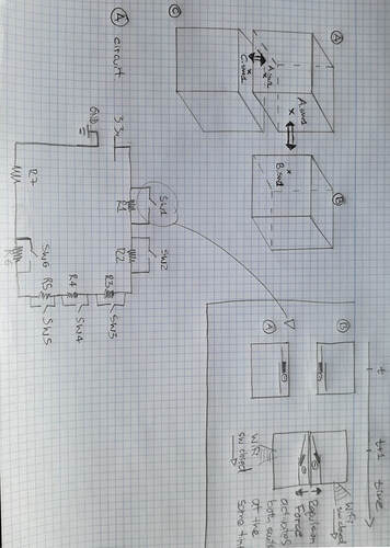

Just noticed the second attachment that appeared at the OP. Hereby both, easier than downloading:
smarichal: please don't add attachments to an older post, they're not noticed!
Sorry, I couldn't find the option to attach a file in the response, so I had to edit the original post.
smarichal:
You can do this if you click Preview first.
