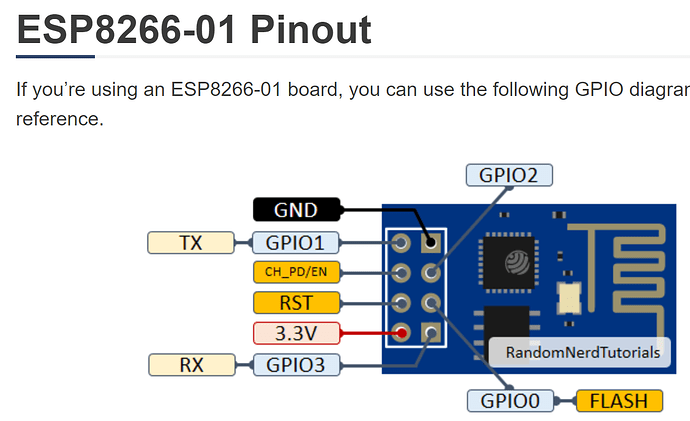

How to connect ESP-01 to read a connected relay switch?
I have used ESP-07S modules which I used to build interfaces to electricity meters etc.
It has lots of available I/O pins, but is more of a project to put together.
Now I need to make a smaller system to only read the state of a single relay contact and send a message via MQTT every time it changes state.
For cost and space reasons I am thinking about using an ESP-01 module, but I am confused by what I read online concerning this module especially about the I/O usage...
There are 4 I/O pins available on the header:
  • RxD
  • TxD
  • GPIO 0
  • GPIO 2
I cannot use the serial pins because they are needed for programming the chip.
So I am left with GPIO 0 and 2..
Since GPIO 0 is hard coded by the chip to select between normal and flash programming modes I believe that my only remaining choice here is GPIO 2.
Is this correctly understood? Is GPIO 2 free for general use?
I plan on using a 10K pull-up on the pin with a small debounce capacitor to ground so the pin is high with the relay contact open. The relay shorts to ground when activated but only for a short time (some milliseconds). But it happens with longer times in between (minutes to hours).
When it does then the capacitor immediately discharges and there is the debounce on the pin.
Any suggestions?

What I am wondering is if the ESP-01 GPIO2 can be used or if there is some gotcha like GPIO2 is being reserved for something else as well.

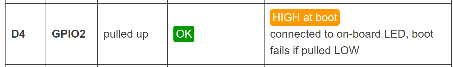

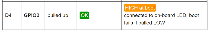

Hi @BosseB
if you take a look into the table of this website
You can see that GPIO2 is

You need the RX & Tx pins for programming the chip, but afterwards they are free to use, unless you intend to use the UART during run-time
GPIO 0 is also free for use, it only needs to be LOW at boot to initialize Flash mode, so that is it's limitation.
That same limitation applies to GPIO 2 & TX(GPIO1).
There is a blue LED active LOW on GPIO 1 (TX)
