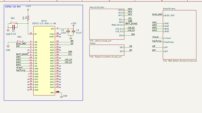

So I designed a custom PCB using a ESP32-S3 Mini but am getting repeated issues with flashing to it. I am able to flash to it once I enter bootloader mode, flash, reset, and then the code I uploaded runs. But if I edit anything and reupload, it again errors when trying to upload. So I AM able to upload to this board, but only when in bootloader mode (why I am not sure...)
Error Messages:
A serial exception error occurred: Write timeout
Note: This error originates from pySerial. It is likely not a problem with esptool, but with the hardware connection or drivers.
System Information:
W10, Arduino 2.3.3
Code:

Edit: Thanks! Including images is a much better idea for sharing the board files

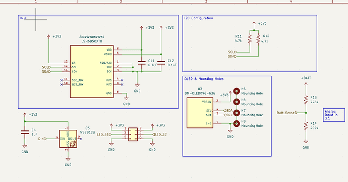

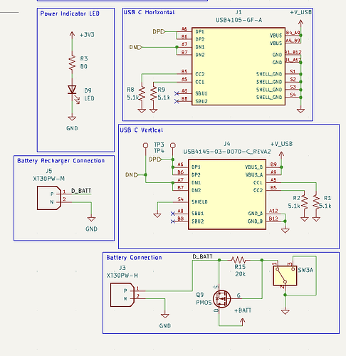

Further adding on, I've confirmed the following parts of the board operate as intended
  • 3v3 Line
  • Power Indicator
  • WS2812B LED
  • The motors drive channels AIN1, AIN2, BIN1, BIN2
  • We need to see a JPEG image of the schematic of our PCB.
Nobody wants zip-files so no loss.
As a new user Im not allowed to have 3+ images, so here is one last schematic photo in the reply

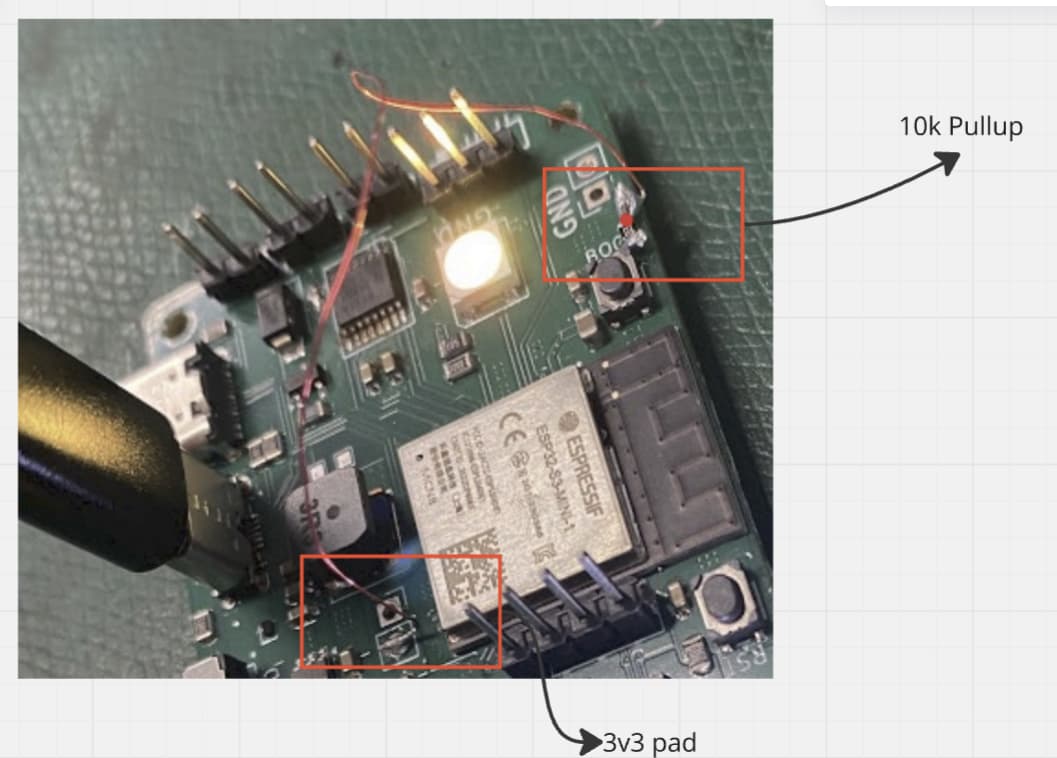

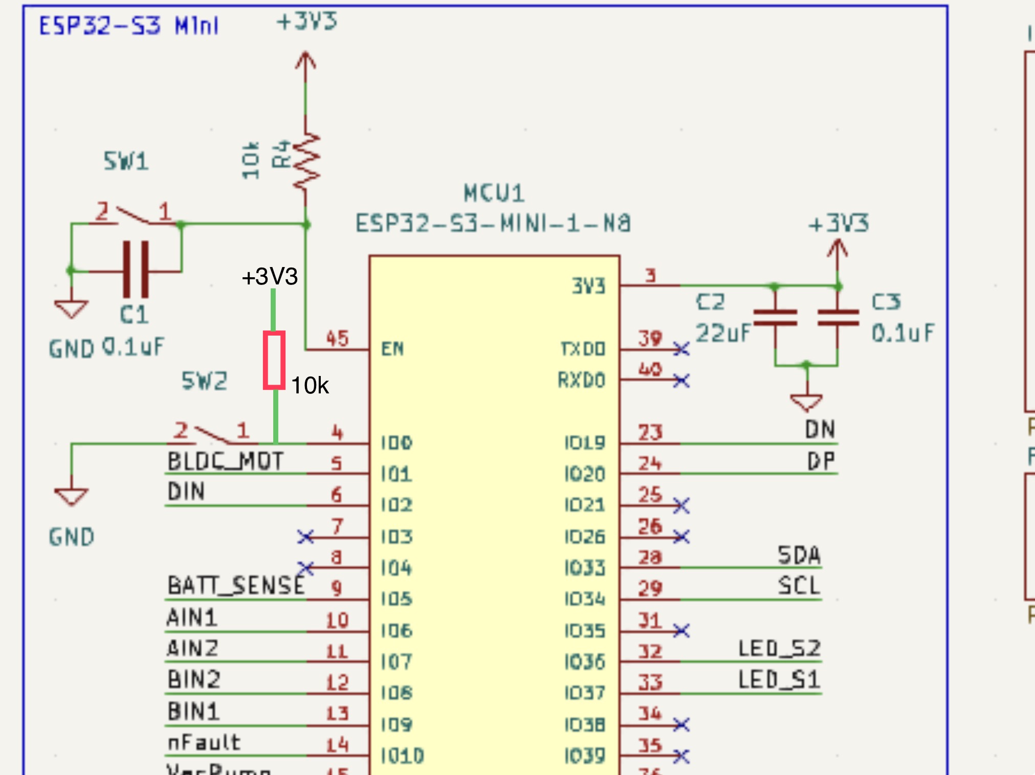

  • First try a 10k pull-up resistor on pin 4 IO0
Hmmm... still the same issue arises even when I have attached the 10k pull up resistor
Im sure its not the connection itself, I proped connectivity between the 3v3 side of the resistor & other 3v3 pads and that was connected, and the button connection to the resistor was also good.
Any other ideas? (Sorry for the late response I have been somewhat sick :C)
