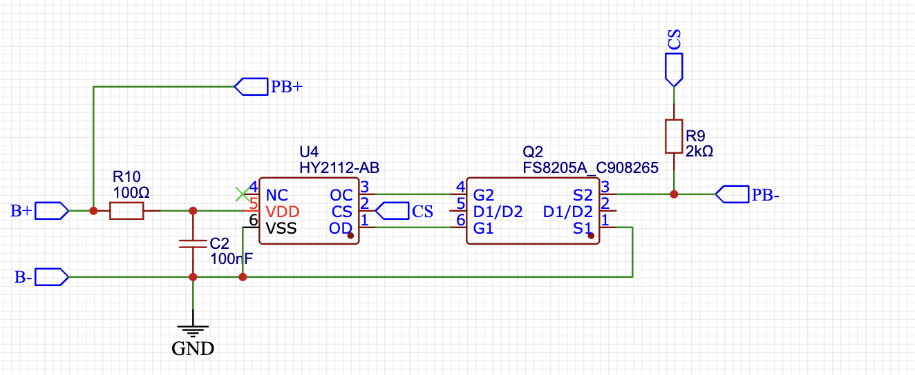

I am currently designing a protection circuit for a lifepo4 battery as a part of a bigger project. The charging is handled externally (as it is a small package) so my circuit only contains the protection circuit. I need to verify that this is the correct wiring and component choice for the application. The other thing is I want to know whether pulldown resistors are required for the FS8205. If they are, I need to know is the maximum possible resistance, as I am trying to conserve power wherever possible in this device. I have included the schematic below

No they are not.
Even though D1/D2 is connected internally, I would sill connect them externally.
