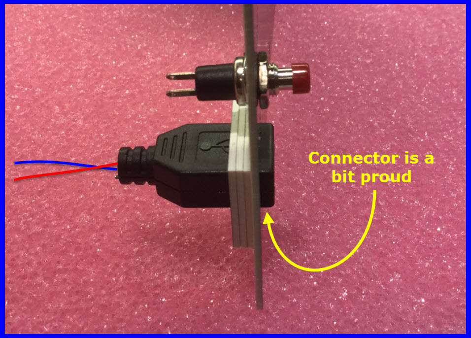

In one project I cut holes in the box and mounted my Arduino Uno so I could plug a USB or barrel-power plug directly into the board. I don't know if that's possible with the ESP.
You could also look for a panel-mount USB cable or panel-mount USB connector.
You can use this method if you need a USB connector.
See:
https://forum.arduino.cc/index.php?topic=445951.msg3140658#msg3140658

USB "A" power adapters are cheap 5v power supplies for projects.
I just make up a cable length as needed (no data wires), USB male "A" to "A" the female jack in post #9 works great.
For just powering a project this setup works great.
