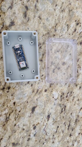

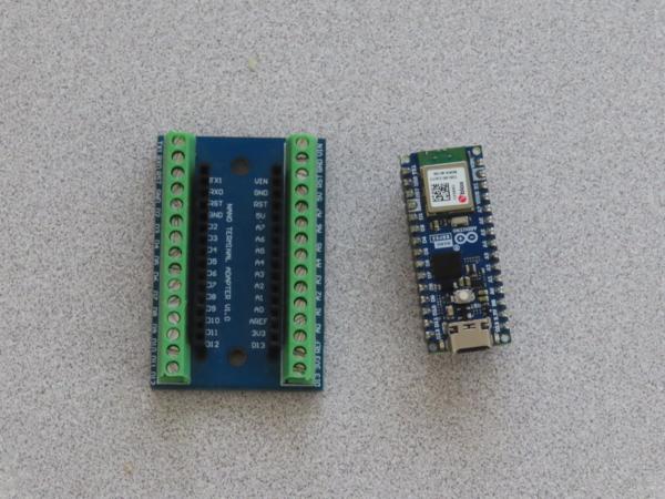

I would like some suggestions on how to make this more professional:

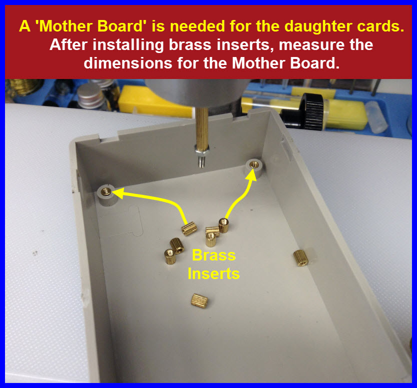

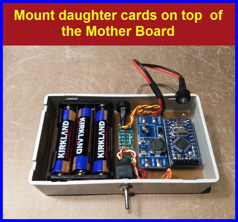

I would like to find something to hold the board in the project box. Maybe a 3d printed something. The box will go into a car on the inside, so it will be subject to vibrations.
I would like to find some rubber grommets for two wires that need to come out of the box. I really didn't want to buy a set on Amazon of 200 pieces with a lot of sizes that I will never use. These wires are 1/8" and there are only two of them.

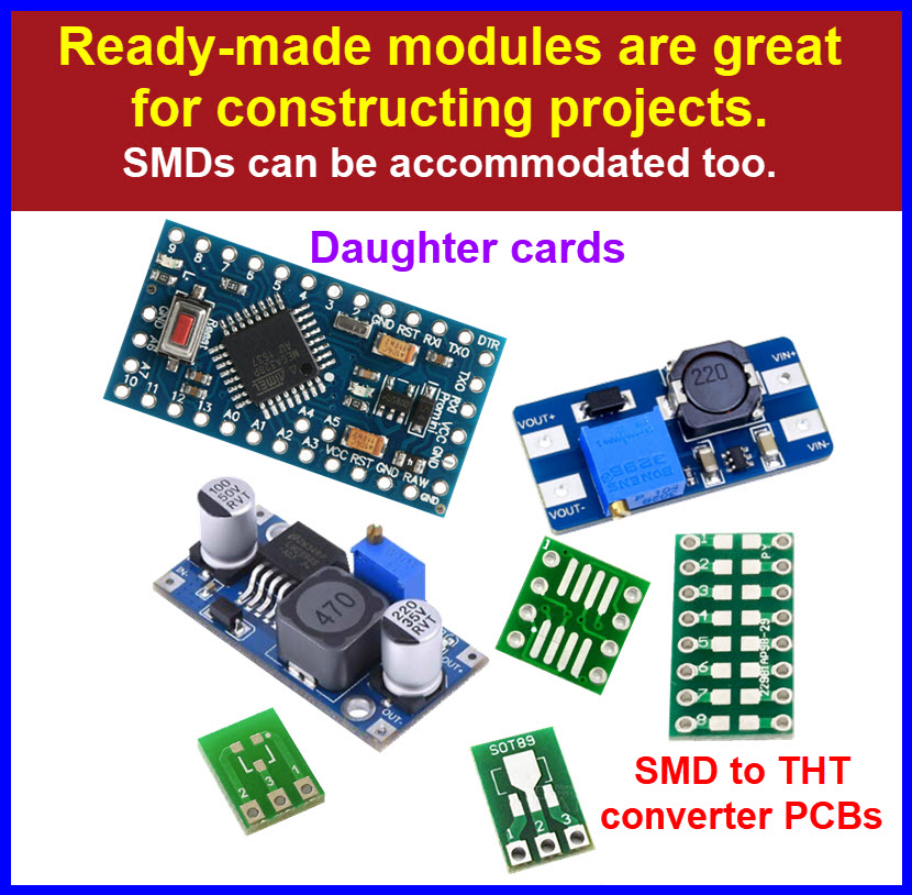

These breakout boards can be handy at times and are ready available from Amazon.
Try black RTV!
