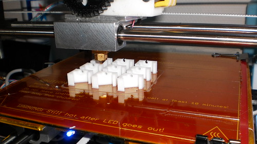

I needed some light in my living room and decided to make it myself.
The lights are some cheap LED strips from eBay with a red, green and blue led on a little cluster.
Parts used for this project:
  • Arduino nano
  • Ethernet shield
  • ULN2003
  • LED strip
  • (20 plastic clips)
  • (3D printer)
It is made so the colors will fade between the selected, instead of just switching.
To set a color, call http ://192.168.1.50/255-255-255 this will then stay for 60 seconds, and fade back to the sticky setting.
If you want to make a color stick, call http ://192.168.1.50/_255-255-255_STICK and it will then fade to this. If someone else then changes the color without the STICK in the end, it will change to that color, and fade back to the setting you made with the STICK in the end.
This way people can still play with the light, without I have to worry about it being turned on all day.

Well no-one has complimented you on a job well done yet so I do. Its a lot of work to make the clips and boards and make them run as well . Thats a CNC machine is it . Did you make that yourself too?
Well done anyway . Its very satisfying personally to achieve such results

Thank you :slight_smile:
I made the 3D printer myself too yes. Isn't that hard making the clips with it, took me around 15 minutes to design the first, and another 15 minutes with a few tries to get it the perfect size.
After that I just had to put in how many columns and rows of them I wanted, and they were then printed fully automated. :slight_smile:
