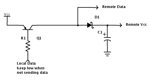

Why can't you use a transistor on the local end to modulate the 5V feed from the local power rail so you have no 40mA current limit. You would need to put a resistor on the remote input pin though.
couldn’t you use a lowpass filter to get the data out, and then connect that in paralell to the power lines?
EDIT: schematics attatched. I know they’re horrible, but that’s the best I can do with fritzing.
The problem with the resistor and the diode is that, at its heart, the resistor and capacitor act as an averaging mechanism, in addition to the voltage divider formed by the resistor and the circuitry at the receiving end.
You could use two transistors, one normally switches power to the Data/Power line. Then when you send a Low, that transistor switches off, and another grounds the line. The far end is wired up just as you show it.
You might not even need the second grounding transistor, if the capacitance of the transmission wires isn't too high versus the data rate. A resistor connected to ground from that Data/Power line may be sufficient to pull it Low quickly enough, then you just need a PNP or P-channel MOSFET transistor to switch power on and off.

Just to summarize what everyone has presented, and a thought or two of my own. I literally drew a schematic. Sorry, I tried fritzing, but am not up to speed on that yet, so it did not work.
Decrease resistor on source, to get a bit more power. Change the diode to a Schottky to get a bit more voltage to the capacitor/slave. Add 10k and zener to get a safe signal into the slave.
And of course, a low power cpu would be a great help to.
Link to schematic: https://sphotos-a-ord.xx.fbcdn.net/hphotos-frc1/1004826_4564688855660_1496010711_n.jpg

If you don't have a zener to protect the input D0, what will happen if the 5V pin on the slave is at 3.5 volts, and you send 5 volts to pin D0. Input pins being 1.5 volts higher than the 5V pin would be dangerous wouldn't it?
That's a good point. With mine, or with a sufficiently low resistor, it shouldn't be more than one diode drop above. Woulda, shoulda, coulda. So probably a good idea to do something to avoid what jackwp points out.
Yea, I see your point about only one diode drop above. So, would that be safe for the input? I am not sure at what point it would become a danger.
With this thread, I am reminded of how impressed I was with the Lego Mindstorms 1.0 sensor/controller bus solution...
I would think with a schottky diode, you’d be fine as it would be less than the voltage required to forward bias the internal protection diodes. However, it is as simple as adding a diode in series with the line going to the receiving Arduino to drop out one diode drop of voltage.
