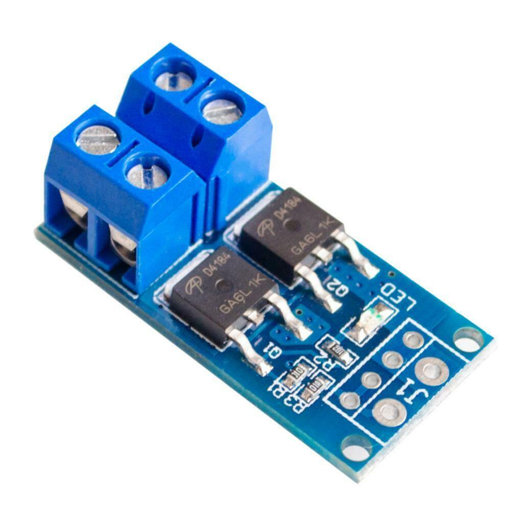

I've attached a photo of the switchboard to show asthetically why I am using the Foteks. On the left are 4 x AC SSRs and on the right are 7 x DC SSRs, plus quality 12V and 24V Meanwell power supplies on the wall feeding the relevant DC SSRs. The AC and DC SSRs neatly match each other and have solid screw terminals and indicator LED. Is there a high speed MOSFET you have come across to do a 15A DC load? (Wishlist is that is at least partly packaged up with screw terminals.) Alternatively, is there an off-the-shelf terminal box I can dump the MOSFET, LED and a few anciliary component into?
Surely I'm not the first person to want to dim commercial/domestic multiple LED strips directly from an Arduino? Soldering a few components and a MOSFET to a vero board and sticking it in a small junction box is pretty agricultural, but maybe that's what I have to do?

Yep, so far my research had led me to the following module from Banggood or AliExpress, that has bigger terminals than most.
When it finally turns up from China in a month's time, I'll look at a way of easily but securely being able to mount it in cabinet as per previous photo.
Maybe even look at reverse engineering it onto a board with more room for mounting screws/bolts and terminals large enough to accept 2.5mm sq cable and a heatsink on the MOSFET. Oh yeah!
I'll post some photos then - assuming the MOSFET in these modules will solve my flickering problem, although I'm confident that the switching time of the F5305S will be fine.

My apologies, I misread the printing on the device. Any particular reason you're going with a P-channel mosfet? I'd just use a low side switch and hence a logic level N-channel mosfet - which is easier to drive and switches faster. Either could work I suppose, but it's somewhat more common to use a low side switch in this case.

Koraks, this F5305S is in the Chinese module from AliExpress, not my design. This module is cheaper than I can purchase the discrete components, so if it works all good. Then I might go down the re-engineering track and make a more robust version. Yep, I agree N-channel is most common and easiest to work with an Arduino output, but I guess the designers of the module has their reasons.
I understand the module is not your design. Many, many similar modules can be had from the same source with more usual N-channel mosfets. I even have a few I bought before doing my own PCB's.

My complaint is not so much about robustness, but about suitability for your project. IMO a low-side N-channel switch is a more obvious choice. Again, thousands of shops on AliE. offer modules for this. Getting the right kind will save you the hassle of having to mount a heatsink onto a mosfet, which would be completely unnecessary for your application.

Well, as expected they're not commercial quality, but the modules I ordered certainly work well without any flicker and run cool at about 2.5A. I've temporarily clicked them nicely into pieces of slotted duct lid to provide insulation from the metal gear tray. As you can see, 2 x 1.5mm sq cables are about the maximum you're going to fit into those screw terminals. So, ideally I'll eventually re-engineer it all into something that looks and acts as sturdy as the Fotek SSR above.
Anyway, problem solved, as at least we can confirm that the Fotek DC SSR's are definitely not just MOSFETS, and I'll be keeping them for larger loads that don't need dimming.
