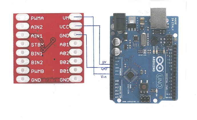

You need to provide a diagram of how you have the power hooked to the motor driver and Arduino.

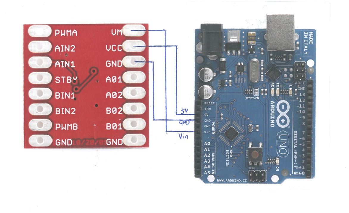

see attachment for wiring.
power sources I tried:
Laptop --> Arduino USB Port: works
DC Power Supply w/ USB Plug Adapter --> Arduino USB Port: works
DC Power Supply --> Arduino DC Jack: doesn't work
Why do you have the motor supply (VM) going to Vin on the Arduino? That doesn't make sense. The VM pin should be hooked up to the positive supply rail of the power supply driving your motors. DO NOT hook it up to the Arduino 5V pin. Vcc to the 5V pin is probably ok, though it may or may not be pushing the regulator on the Arduino.
I can't read the Toshiba PDF datasheet for the chip on my Ubuntu reader (most of the tables are blank - must be the version of PDF they used or something), but somewhere it should say how much current the chip draws on Vcc; you may want a separate 5V regulated supply for it, instead of taxing the regulator on the Arduino.
So - to recap:
  1. Hook all grounds together
  2. Possibly use a separate 5V regulated supply for the Sparkfun driver board (to Vcc)
  3. Supply VM with a separate higher current supply (like the one you have, or some batteries)
  4. Don't supply more than about 7 volts or so to the motors
Regarding item 4: The small hobby motors used in the gearbox can be somewhat "overdriven" by 10-15% without much damage - you may shorten their life a bit. What you may want to do is stick with 6 volts only until you get things really working, then once you have it working well, measure the voltage output of the chip at max PWM; you may find (see the chip datasheet, once again) that there may be a slight voltage drop from the input motor power supply to the output for the motors. If this is the case, increase the input supply until the output matches what the maximum the motors are spec'd at (or a little more), in this case, 6 volts.
I thought by using Vin I could drive the whole setup with a single power supply. Vin would supply, say 7 Volts from the Power Supply or batteries, for driving the motors, and the +5 Pin a regulated-down 5 Volts for the Driver Vcc and some LEDs, Sensors that I have hooked up as well. Is that possible at all?

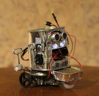

The thing is, all should be as compact and mobile as possible. Is going to be a small autonomously moving robot-like contraption. (See attached picture)

You're using the Uno's "Vin" pin as a "Vout"? I don't know how Vin is connected electrically, but it doesn't seem safe to assume that it's a direct connection to either the USB supply, or the coax socket. The USB supply ought to be providing a regulated 5V. Does your USB lead have some sort of regulator built in?

I suspect the issue has to do with a couple of things:
  1. Vin and the USB are connected in such a way for auto-switchover of one or the other (I believe USB might have precedence - I'm not sure). See the schematic here: http://arduino.cc/en/uploads/Main/arduino-uno-schematic.pdf
  2. If you are trying to drive the motors off of 7 volts, while using Vin as a "Vout" - the motors are probably taking the current, leaving little for the Arduino's 5V regulator (which isn't a low-dropout device - it needs at least 7 volts to work) - things just don't work right.
Skip trying to use Vin - it is the wrong solution. If you must use a single supply, and you have to keep it around 6-7 volts, then you might have to look into building your own "standalone" Arduino, and using a low-dropout regulator for the 5 volts, or a switching regulator - so that you can run it from 6-7 volts (you might look into using a hobby R/C BEC, using a 7.2 volt battery source for everything).
Another option might be to use a larger battery (something with the capacity for the motors, at around 9.6 volts) then using a seperate 6 volt regulator for the motors (not the best solution, mind you). Still another possibility would be to use a 6-cell AA battery pack, and tap off the fourth or fifth cell to provide the power to the motors, but use all 6 cells for the Arduino (via the Arduino's regulator).
Thanks again guys for your help. After tying together all the GNDs of the driver chip the setup works with a single power supply of 6x1.2V, 7200mAH, NiMH Recharchables.
