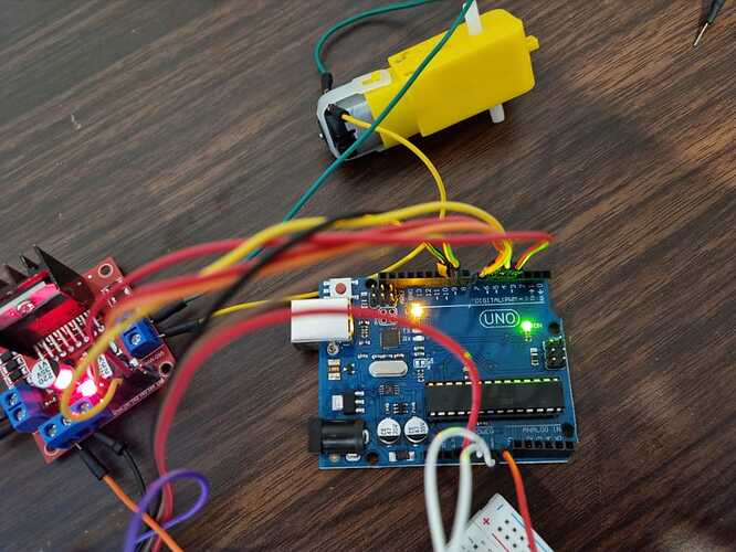

Hello! I am making an obstacle avoidance robot and it is my very first robot. I use an Arduino UNO, breadboard, h-bridge L298N, 2 DC motors, and an ultrasonic sensor. When I plug my batteries, Arduino and h-bridge receive power as their lights are up; however, DC motors do not. Because when I plug batteries directly into motors, they work. If anyone could explain me what is the issue, I would be really glad.

It appears the ENA and ENB jumpers are not installed. :thinking:
The schematics don't show that there is any connection with ENA and ENB. And I took jumper caps before for another project. Would not having jumper caps affect it?
You either need to add them back or you can connect them to PWM pins to control the motor speeds.
And I think a 9v pp3 spoke alarm battery will struggle to supply 2 motors and an ultrasonic sensor for very long!
Thank you so much! I added them back and it worked.
