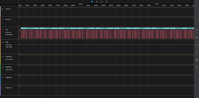

I tried to get data using a logic analyzer, but it didn't work very well, I have 3 repeating values ​​that change only after the gas or steering wheel have deviated by more than 50%. I admit that this is how the microcircuit itself works. In the logic analyzer I used BAUD 1500.

I sampled 1MS/S and this is what I got
If you look, the data is shifted and repeated.
0x035C5103
0xF1035C5F
0xBF5F025D
0x03BF5103
0x5103BF5F
0xBF5F03BF
0x03BF5103
0x5103BF5F
According to my understanding, the full bit length is 766 uS, and half is 383 uS
What do I need to do next?
I should see the start of the Manchester code, since I turn on the remote and it starts transmitting.
The bit rate should be 1300 ( 1000000/766 )
If you have a saleae try adding an analyzer 'manchester' at 1300 baud ( to see if it works ) You already added, what bit rate did you use?
The arduino library I found does not support 1300bit/sec ( maybe it can be added, or use another library ), or you may try with 1200, not sure it will work
It seems to me that my settings are not quite correct.
It seems that there is another information block, like 1010 or 1111, could it be here?
