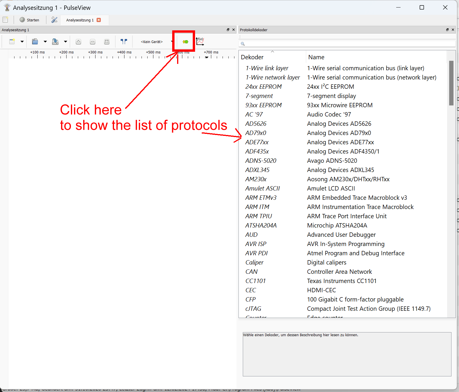

The software PulseView that records the bits has a protocol-decoder which can decode a lot of protocols
https://sigrok.org/wiki/Protocol_decoders
What software did you use to record the signal?
Was it pulseView ?
or
Something else?
I guess PulseView is compatible with Salae because pulseview mentions salae as a usable recording device

This is how I see it: They probably started with Serial/UART at 9600 baud. They probably use software to send and receive the data. Perhaps there are interrupts that take some time, so they had to lower the baudrate to 2400 to make it work.
PulseView has a decoder called "UART", set the Baud rate to 2400 and it should read data.
On the Arduino Uno, a SoftwareSerial port should be able to read the data.
